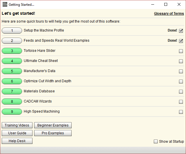

Getting Started Tours
The Getting Started Tours that are built right into G-Wizard are your best bet for learning the software.
Here’s what the Getting Started popup looks like:
Getting Started Tours…
The Getting Started Tours will pop up every time you start G-Wizard until you uncheck the “Show at Startup” box in the lower right corner. You will not be able to suppress them until you’ve at least completed the “Setup the Machine Profile” tour.
You can also get it to popup by clicking the “Getting Started” button at the top of the G-Wizard window:
Click the Getting Started button up top to bring up the Tours Popup…
The Getting Started Tours are accessed by clicking one of the Green Buttons. There are 8 tours to get your started:
- Setup the Machine Profile
- Quick Feeds and Speeds Tour
- Tortoise Hare Slider
- Ultimate Cheat Sheet
- Manufacturer’s Data
- Optimize Cut Depth and Cut Width
- Materials Database
- CADCAM Wizard
- High Speed Machining
Each is designed to provide you with a quick (5 minutes max) tour of the specific area. We recommend taking the tours in order, but you can do them any way you want.
The Getting Started popup will remember which tours you’ve already taken for you as well.
If you’re a trial user, try to do all 8 tours as soon as you can, because they’ll equip you to get the full value out of G-Wizard.
Over time, we’ll add more tours, but in the meanwhile, there are 3 other buttons with more help at the bottom:
- Training Videos: This is our G-Wizard Video University, which has a variety of quick videos to help.
- User Guide: Our written documentation
- Help Desk: Our Help Desk page, with download links, customer service, and much more.

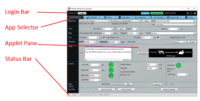

Basic Screen Layout and Navigation

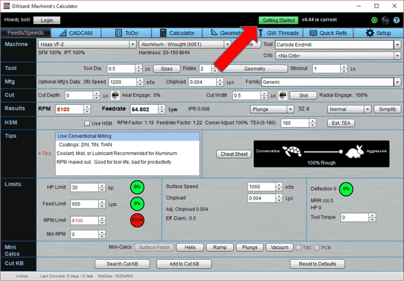

Here’s what G-Wizard Calcualtor looks like after you’ve successfully logged in and set it up with your CNC machine information:
G-Wizard Screen Areas
Login Bar
The Login Bar at the top has a bunch of handy features and buttons you’ll refer to from time to time:
– Login Area: You can press the login button to logoff or change your login. Most users just leave G-Wizard logged in all the time.
– Getting Started: This button pops up the “Getting Started” Tours. They provide step-by-step tours of all the most important functions in G-Wizard.
– Version: This message area will tell you whether the version you’re running is the latest or not and what that version is. If there is a newer version available, there’ll be a button to take you to the download page.
The last three little round buttons are grapical. Just let your mouse pointer hover over them to see a description of what they are:
– Support: Takes you to our online support site where you can file a trouble ticket, consult the FAQs, or vote on ideas for what features we should build next.
– Tips: This pops up our Tip window which gives you tips on how to get more out of G-Wizard.
– Help: Takes you to an online help page that we think is relevant to the applet you’re in. The list is in the column on the left with links.

Feeds/Speeds
G-Wizard’s Feeds and Speeds Calculator is the most sophisticated Feeds and Speeds Calculator available in the market today:
No other Feeds and Speeds Calculator offers this much depth of analysis…
No other Feeds and Speeds Calculator offers this much depth of analysis or this many features to help you figure the best Feeds and Speeds. Some of the key innovations at work here include:
– User-Definable Machine Profiles tell G-Wizard what your CNC machine is capable of.
– Large Materials Database with allows and conditions
– Support for Multiple Tool Cribs
– Extensive Support for Complex Tool Geometries and Many Different Tool Types
– Mini-Calcs Give You Help With Surface Finish, Interpolated Holes, Ramp Angles, and Plunge Milling
– Support for Through Spindle Coolant (TSC) and Programmable Coolant Nozzles (PCN)
– Exclusive Cut Optimizer Maximizes Your Cutting Parameters While Managing Tool Deflection Within Limits
– Extensive Support to Manage Machine Strengths and Weakness Including Spindle Power Curve, Rigidity Adjustment for Small Machines, Spindle Power, Axis Acceleration, and Axis Motion Limits, and More
– Extensive Features to Use Manufacturer’s Recommended Data. Mfg’s Data can be used on the fly or databased with the Tool Crib.
– In-Depth Calculation of Cutting Parameters Ranging From RPM and Feedrate to Details Such As Power Required, Material Removal Rates, Deflection, Torque Requirements and More
– Powerful Support for High Speed Machining Toolpaths
– Tips that Bring Important Information from Manufacturer’s Data Sheets Straight to Your Specific Cutting Scenarios. G-Wizard Will Remind You of Everything from When to Use Climb vs Conventional Milling to When Parabolic Flutes are Needed for Hole Drilling.
– Our Exclusive Tortoise-Hare Gas Pedal Slider Lets you Decide Whether You Want Aggressive or Conservative Cutting and Whether to Emphasize Maximum Roughing Speeds or Focus on Tool Life and Surface Finish.
– Knowledge Based Machining Comes to G-Wizard in the Form of Our Cut Knowledge Base Which Lets You Track the Actual Results Your Shop is Getting So You Can Leverage that Information Over Time
– Exclusive features for CNC Routers and CNC Lathes that are not available anywhere else.

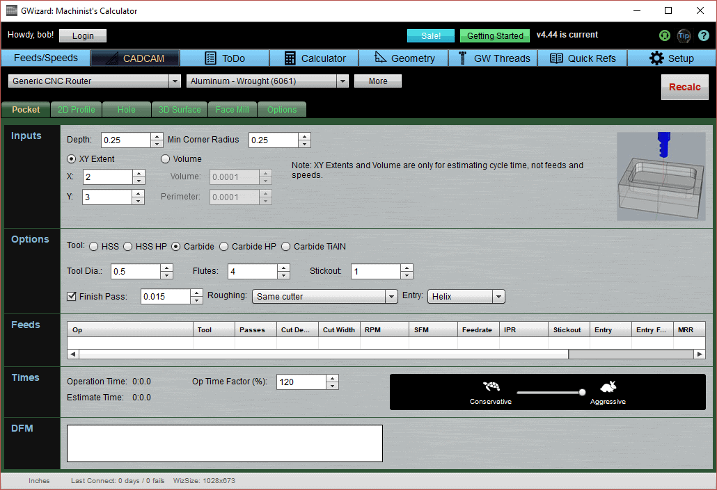

CADCAM Wizards
CADCAM Wizards are a unique feature to G-Wizard Calculator that provide the next generation of Feeds and Speeds. Their purpose is to radically simplify calculation of feeds and speeds while at the same time giving much more optimal answers. Whether you’re a beginner or an expert CNC’er, CADCAM Wizards can give you a complete machining recipe for your CAM software that can dramatically reduce your cycle times and improve your results all while requiring a lot less data input than conventional approaches to Feeds and Speeds.
CADCAM Wizards are designed from the perspective of your CAM software instead of from the perspective of Feeds and Speeds thinking dating back to manual machining practices. They’re designed to figure out everything you need to know to answer the questions your CAM software needs to have answered about feets and speeds, cut depth and width (stepover), and all sorts of other things. They’re also the kicking-off point for estimating the cost to manufacture a part using CADCAM Estimator. Here is the CADCAM Pocketing Wizard:
CADCAM Wizards are designed to work hand in hand with your CAM software…
Conventional Feeds and Speeds starts with questions like what kind of tool you want to use and what cut depth and width would you like. CADCAM Wizard “thinks” like your CAM software, so it starts with which CAM operation you’d like to perform–pocketing, 2D profiling, Holes, Face Milling, and so on. When you’ve given it the basics, it tells you what it thinks the best cutter, cut depth, cut width, and other parameters would be. It also provides a detailed estimate of the time it thinks the operation will require.
While you may have purchased G-Wizard because it has the world’s best Feeds and Speeds Calculator, don’t overlook CADCAM Wizard, which can give you even more, and which is built on the very same Feeds and Speeds calculation engine. CADCAM Wizards can save you time and money.

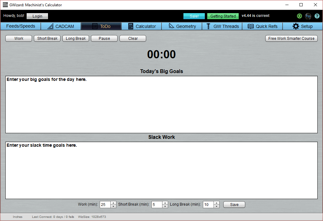

ToDo: Personal Productivity Enhancer
G-Wizard’s ToDo productivity applet uses the proven Pomodoro technique to make you more productive during the workday. We even offer a complete free online video course called “Work Smarter” in how to maximize your personal productivity. Just click the button at top right of the ToDo applet to access the course.

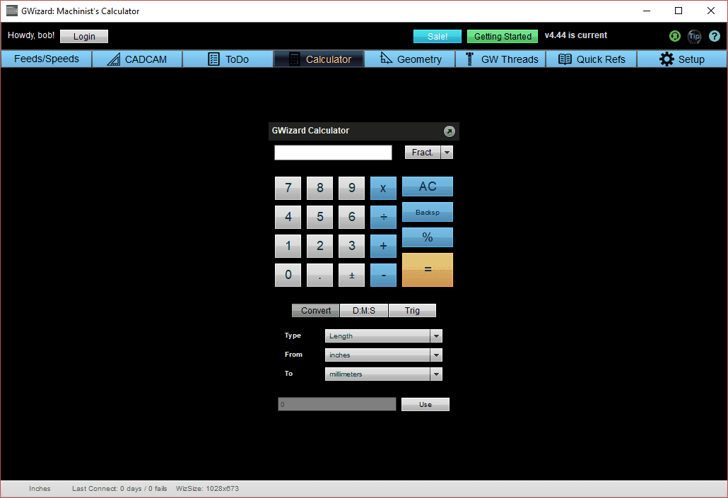

Calculator
Calculator is a Full-Function Scientific and Engineering Calculator…
Calculator is a Full-Function Scientific and Engineering Calculator. Since it can be handy to have available while using other functions, there is a handy tear-off feature that lets you pop the Calculator loose from the G-Wizard window. Just press the little arrow in the top right corner of the Calculator.

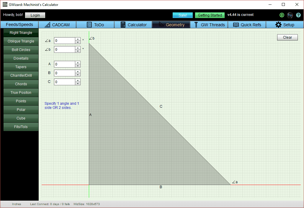

Geometry
G-Wizard’s Geometry Applet helps you to solve a variety of shop geometry problems involving Trig, Circle Chords, Depth Calculations for Cutters, Tapers, and More:
There’s even an ISO Fits and Tolerances Calculator and a Turner’s Cube Calculator.

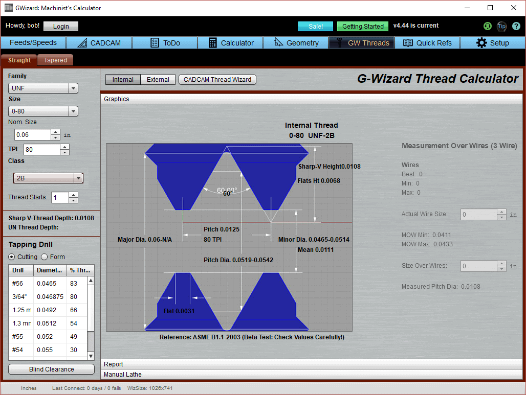

Thread Calculator and Database
The Threads Calculator provides critical dimension information for common thread sizes and families:
In addition to dimension information on the threads, you’ll find tapping drill information that includes a chart of thread percentages so you can choose the best tapping drill for your application.
There are two versions of the Thread Calculator–Free and Premium. The Premium Version has a lot more Thread Families and features.

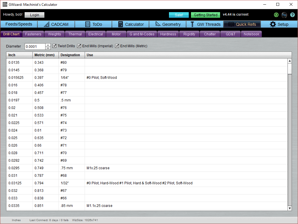

Quick Refs
Quick Refs provides the myriad other reference materials any machinist or engineer will want to have handy when they need it:
You’ll have to wrestle with your Machinist’s Handbook a lot less when you have all this information available in G-Wizard:
– Drill Chart shows all the standard drill sizes and their uses.
– Fasteners gives a handy database of common fasteners and their dimensions.
– Weights calculates weights and volumes of work materials and includes all the standard sizes they’re available in.
– Thermal calculates thermal expansion and contraction to help you ensure accuracy in your work.
– Electrical is a grab bag of useful information for electrical work including resistor color values and an Ohm’s law calculator.
– Motor helps do CNC servo and stepper motor-related calculations.
– G and M Codes provides handy reference tables of common G- and M-Codes for CNC programming.
– Hardness cross references all the different material hardness systems to help you convert from one to the other.
– Rigidity helps you evaluate trades offs in your tooling selection related to rigidity to help you keep chatter and tool deflection under control.
– Chatter helps you calculate spindle rpm ranges that will minimize or eliminate chatter from your work.
– Notebook is there for all the things we forgot to add. It lets you bookmark resources on the web and pdf files on your machine so you can bring them up for reference in G-Wizard too!

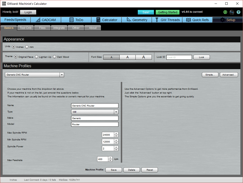

Setup
The Setup applet lets you configure G-Wizard for your application, machinery, and shop’s best practices:
Using Setup, you can tell G-Wizard:
– Units: What unit system would you like to use, Metric or Imperial?
– Machine Profiles: Tell G-Wizard the capabilities of each of your CNC machines.
– Tool Crib: Define Tool Cribs
– Files: See where all of your Preferences and Setup information are stored on your machine so you can back it up if you so desire
– Integrate: Integration options for CAM software
– Other: Other Setup options for G-Wizard
– About: Lots of useful information on About such as how many days of trial or subscription you have left on G-Wizard

But, there’s at least one thing you can do to help make that smoother, and that is setting up Machine Profile for the different machine tools you’ll be using. It’s not hard to set up a Profile–just a matter of giving G-Wizard some basic specs on your machine such as spindle power, maximum and minimum rpms, and the like. To find out more about how to do that, visit our Setup Page. The other thing you’ll learn to do is set G-Wizard’s units to be either Metric or Imperial. The product includes full support for both systems.
Once you’ve got a profile in place, you’re ready to start using all the Applets. There’s links to more information about each one over in the lefthand column. We suggest exploring them in left to right order, as they appear on the App Selector. We’ve chosen that order because we think that’s the best order of frequency and simplicity.
