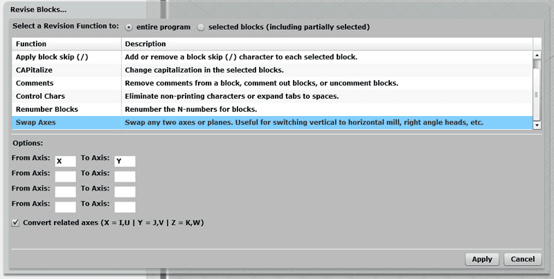

I ran across a request over on CNCZone for the ability to go through a G-code program and swap the axes. Apparently this is useful for writing programs for right angle heads or in some cases for converting a program from a vertical to a horizontal mill. I did a little research and came across two threads over on Practical Machinist that wanted the capability for the same reason. Since it's not hard to do and seemed to be something useful, I put together the capability to do this in G-Wizard G-code Editor. It looks like this:Gray background with white text box, menu bar, toolbar, and multiple windows open in a computer program interface.
Computer screenshot displaying revision menu with radio buttons and function list

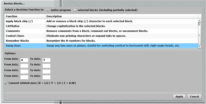

The Swap Axes Revision will swap up to 4 axes and automatically convert the related axes...
With Swap Axes (under the Tools Revisions menu), you can swap up to 4 axes if you need to. Just tell it the "from" letter and the "to" letter. These is also the option to automatically swap any related axes. For example, if you are swapping X to Y, you probably want to swap I to J and U to V (Fanucs lets you use UVW as relative versions of XYZ so you needn't keep switching modes). One click saves you some time. This related axes option is not something I've seen in other editors, but it sure makes sense if you had to do this sort of thing very much. Note that the swap is one way unless you specify both directions. So if you truly want to swap X and Y, you would put X to Y as one line and Y to X as the other.
