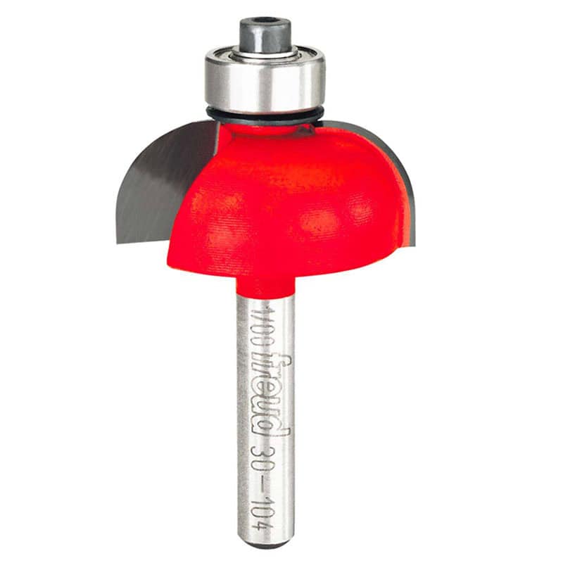

Cove Router Bit
Cove Router Bits cut a semi-circular profile. They're typically used to create moulding features in wood applications.

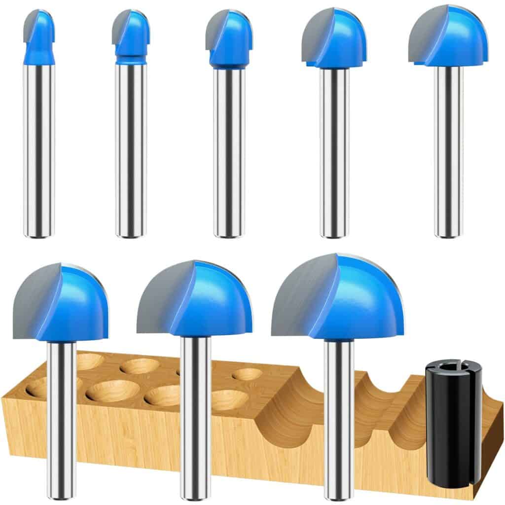

Core Box Router Bit
Yet another type of router bit is the Core Box Router Bit.
