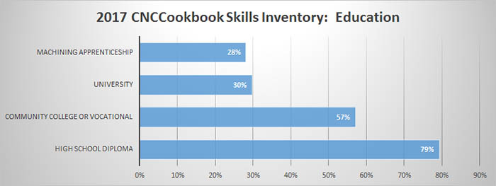

Education
While a degree from a 4 year college or university is uncommon, a bonified completed Machining Apprenticeship is even harder to find these days.

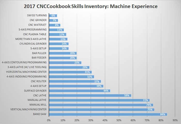

Machine Experience
You know it's going to be tough to get a job if you've never worked on the type of machine they're hiring for. OTOH, employers are going to think it perhaps a bit odd at the very least if you've never run a Band Saw, VMC, Manual Mill, or Manual Lathe. Those seem to be basic prerequisites.
If you get a chance to run any of the fancy stuff that less than 1/3 of your peers have run, jump on it. When those jobs come up, skilled labor will be scarce and you'll have the edge.

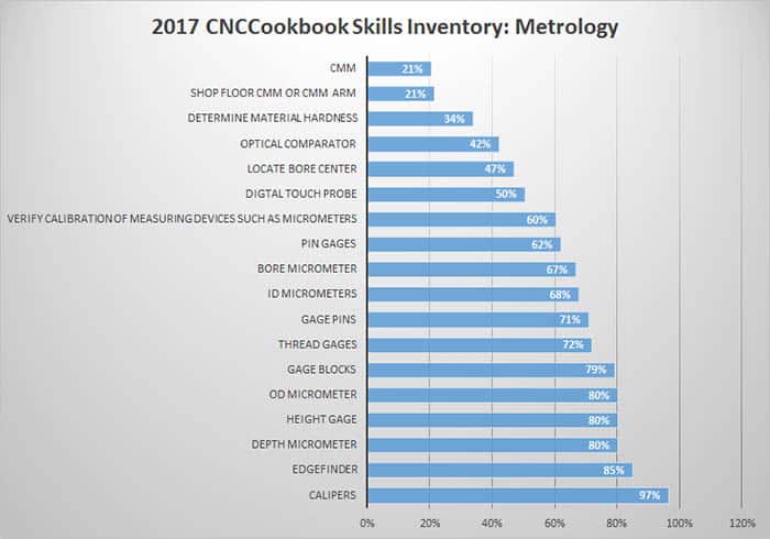

Metrology
So you know how to operate a calipers? As Archie Bunker used to say, "Whoop-tee-do." You'd better be good with an Edgefinder too. After all, you'll need it to set up Part Zero in many shops. Micrometers, Gage Blocks, Thread Gages, Height Gages, and Gage Pins are also going to be expected skills.
Now, how often have you precisely located the center of a bore? Can you use an Optical Comparator? Have you measured the Hardness of a material? And BTW, if you get a chance to do a stint with the shop's CMM (Coordinate Measuring Machine), jump all over that as apparently many of your peers have little exposure to those versatile machines.
We're starting with Metrology to move into skills that will get you out of being a basic CNC Operator and into the realm of the higher paid CNC Machinist. Check out our Complete Guide to Metrology for more information on the valuable skill groups.

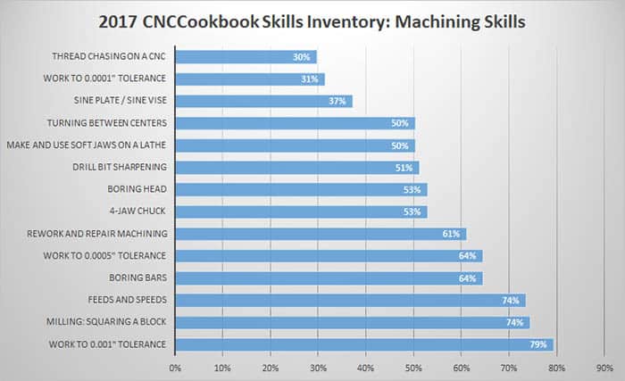

Machining
As a CNC Machinist, you work to a thousandth tolerances easily. You don't hesitate if asked to square a block. Feeds and Speeds? Under control! Hint: G-Wizard Calculator will do a better job for you than all those old guys who think they know it all, keep a copy in your toolbox on a laptop. Speed up a job as so many of our customers tell us they do, and you're a whole new kind of hero. The kind whose results are measured in dollars and cents.
A little more than half of you can manage tolerances to half a thousandth, but less than a third can work to a tenth when called on. Likewise, most will manage a blank look when handed a sine plate and told to set up an angle for a job. Chasing threads on a CNC Lathe (that's one of those ones the boss will remember you saving the bacon on!)?
Fuhgeddaboutit!

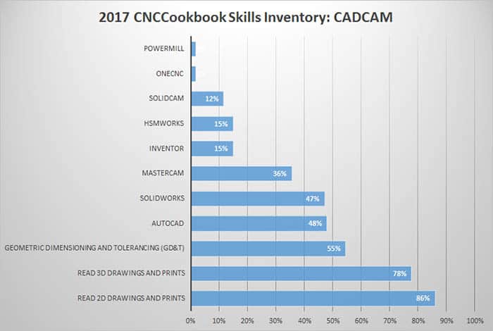

CADCAM
Do you want to talk Digital Tooling? Well, CAD and CAM are the power tools of choice in that arena. This skills inventory tries to evaluate how many of the most popular packages you know, as well as some basic skills associated with reading drawings and CAD models. It's all important.
One thing that surprised me was that over half the respondents are able to use Geometric Dimensioning and Tolerancing (GD&T). That's great! If you haven't caught up to that bandwagon yet, it's fairly critical you pick up the skill. Try our Free GD&T Tutorial Course, and we'll make it easy to get started.
As far as the rest of it, you need to know either AutoCAD or Solidworks in the CAD department and preferably at least a bit of both. They're just so commonly used it's hard to do without that skill. If you had to choose one CAM package, learn Mastercam. Everything else is a lot less common, and I only put out the most common choices from our recent CAM Survey.

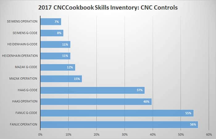

CNC Controls
To operate a machine, you need to know how to run its control. To program the machine, you need to know its g-code dialect.
I listed the most popular controls from our CNC Controller Survey, and if you know nothing else, you should know Fanuc and Haas. If you wanted to add a third, looks like Mazak is the place to go.

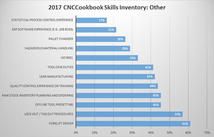

Other
There are probably a million-and-one other skills to consider. I drew the list on the questionnaire by analyzing a whole bunch of CNC Job Advertisements to see what employers were actually asking for. But, here are some other tidbits to consider:
- Relatively few CNC'ers have worked with Titanium (35%) or Super Alloy like Inconel (32%). Experience there is no doubt valuable.
- A lot of CNC'ers have done routine maintenance such as coolant maintenance or topping off way oil. Surprisingly few know how to maintain the power chucks so common on CNC Lathes-just 24%.
- Welding skills are handy to have. 54% of CNC'ers can Mig weld, 37% can stick weld, 30% can Tig weld, but only 26% can gas weld. Considering how versatile gas welding can be, that seems surprising to me. Of all these processes, I actually preferred gas welding. It seemed the most "user-friendly" without requiring quite the extreme dexterity and touch of Tig welding. Every machinist should be a decent welder.
Here are the rest of the "Other" skills ranked:
You want to be able to drive a forklift and be familiar with lock out/tag out procedures. Beyond that, there are a bunch of rarities that might give you a leg up in the workplace. If you're interesting in learning more about Lean Manufacturing, check out our Mini-Course on Lean Manufacturing. Good stuff there.
