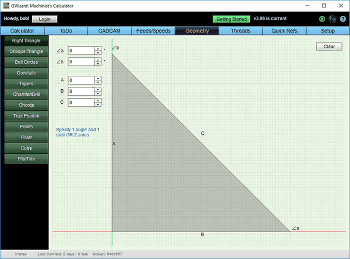

7 Walk me through a problem you recently solved using trigonometry or other shop math. Machining
A decent grasp of Shop Math is pretty important for many CNC positions, and something you'll likely find hard to teach if they don't already need it.
Need a little help with your shop math?
G-Wizard has a comprehensive set of geometry calculators built right in you can play with and use to check your work.
