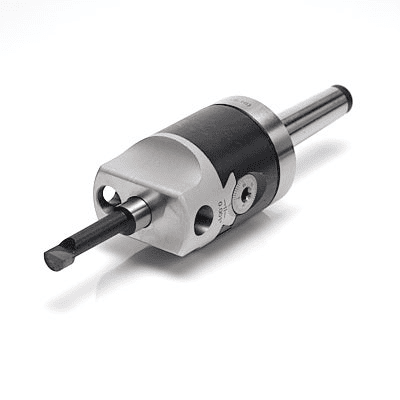

Walter Boring Head
Cylindrical device with silver body and black accents.
Walter makes precision boring heads in Germany.
