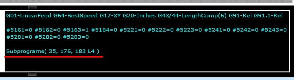

Release 1.023 adds a new macro variables tab where you can see which variables are accessed in your g-code program, their current value, and any symbolic name for the variables.

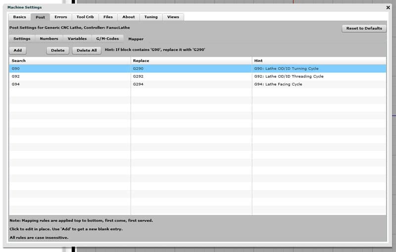

– The Post tab under Settings has a new tab called “Mapper”. Basically, “Mapper” does a search and replace at the last minute before the code is executed. This makes it easy to remap g-codes since different controls have them under different numbers as well as many other things, such as Fanuc A/B/C style lathe g-codes (coming soon!). Here is the Mapper in action changing G90/92/94 to G290/292/294:
G-Code Mapper
– Added G290, G292, and G294 lathe cycles. Normally, these would be G90/92/94, but these codes need to be mapped since their normal slots are used for other things on mills, for example. So, the canned profiles use the Mapper to remap them appropriately so that programs can just refer to G90/92/94. G90 is an OD/ID turning cycle, G92 is a threading cycle, and G94 is a facing cycle.

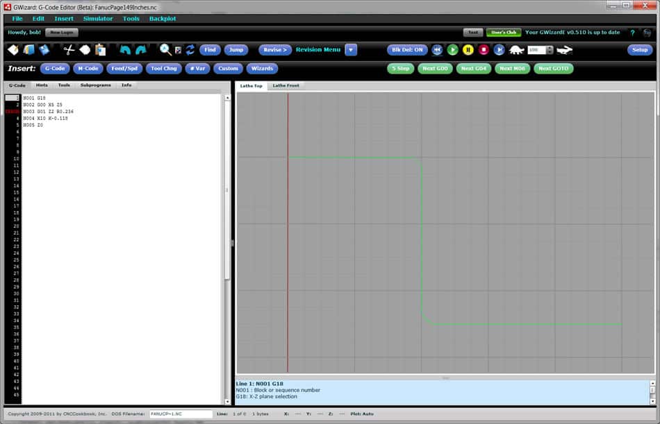

– G01 Chamfer and Corner Rounding for lathes. Note that corner rounding will look like a chamfer on the backplot and there are no post options yet. Also, we need your help debugging, as I didn’t have very many test examples to try it on.
– The Hint and Info tabs are grayed out until a backplot is completed. The information on them is not accurate until a complete backplot has run.

– A new subprogram call list (stack trace) has been added to the simulator info below the backplot. It lists the M97/M98/G65 calls by line number. If there is a repeat factor on the call, it will be reflected by an “L” after the caller line # plus the number of repeats left to execute:
subprogram stack trace

– G20/21 Units: Grid is rescaled to fit the units as are the various coordinate indicators. The default is Imperial, but you can use this g-code in the Post setup g-code to change that.
– Toolholder appears miniaturized along with the yellow highlighting to show where in the backplot the currently selected g-code line is. In Debugger mode, the Toolholder is scaled fullsize to the backplot.
– The line numbers now have a “reverse out” color to make it easier to find the line the cursor is on at all times.
– Lathe diameter vs radius modes are now available for Lathe profiles. Select the option from Setup Post. When in diameter mode a “dia” will appear by the X’s to remind you.
– M98/M99 Subprogams. Style is determined in post. By default, you will be reminded that you haven’t selected a style by an error message. Repeats are not yet implemented–each call is one shot.
– Subprogram tab. There is a new subprogram tab that tells all the “O” subprogram definitions in the current file. In a future release it will also identify “N” numbers accessed via M97. You can double click an entry on this view to go to the line where the “O” is defined.
– M97 for Haas-style subroutine calls. M97 uses the “N” (block) number instead of an “O” number.

  • G- and M-Codes can now be disabled, ignored, or remapped to other codes. Just double click them on the Setup G-/M-Code tab.
