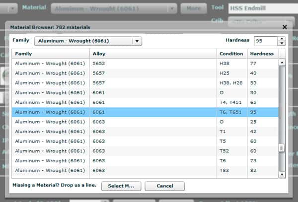

1. "More" Button for Alloys and Conditions
Starting right at the top, we have the "More" button for alloys and conditions. You'll find it just to the right of the Material drop down. Pressing it gives you access to a Popup that is our Materials Database. It is grouped by family, and it gives you the ability to fine tune feeds and speeds based on the alloy and conditional of the material you'll be cutting. It's also useful to figure out what Material category you should choose. For example, hard and soft plastics lists which plastics go in each category. Lastly, if we're missing a material, drop us a line. If you can send cutting data for your material, we can usually figure out how to add it to our database.

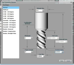

4. Geometry Button
There are lots of variations on the standard flat endmill. The "Geometry" button helps you to tell G-Wizard what sort of variation you've got. It's a big deal, so I'll break it down into sub-features by geometry type.
5. Ballnose Geometry
Ballnoses are very handy endmills to have around for arbitrary 3D profiling. G-Wizard performs some pretty nifty calculations such as chip thinning and feeds and speeds based on the effective diameter which is determined by how far the ball is down in the cut. If cut depth is less than half the tool diameter, there is an effective diameter since the workpiece never sees more than the tip of the ball.
6. V-Bit Geometry
V-Bits are commonly used for engraving. They can be a little more delicate than endmills and they're certainly not as efficient at clearing chips. In addition, the V-shape means there are effective diameter calculations to be made here too.
7. Dovetail Geometry
Dovetails are special-purpose cutters that are not used very often, but they're the only thing for a job when they are needed. Once more we need to factor in the idea that they are delicate as well as do some effective diameter calculations.
8. Router Bit Geometry
The CNC Router gang uses a number of different kinds of bits not commonly found in the metal cutting world. These CNC Router Bits have particular advantages for particular jobs, and G-Wizard knows how to handle them.
9. Bull nose end mill (Corner Radius end mill) Geometry
Bullnoses cost a little more, but that little corner radius often prolongs tool life and cleans up the finish along the edge. Using the Geometry Popup, you can specify a corner radius on an endmill.
It isn't just bullnoses that have these advantages. G-wizard can also handle Face Mill Speeds and Feeds with a lead angle setting.
10. Tapered Endmill Geometry
Some kinds of work benefit from a tapered endmill. G-Wizard lets you specify a taper angle on your endmill.
