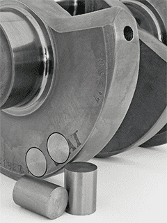

Tungsten slugs used to balance a crankshaft.
