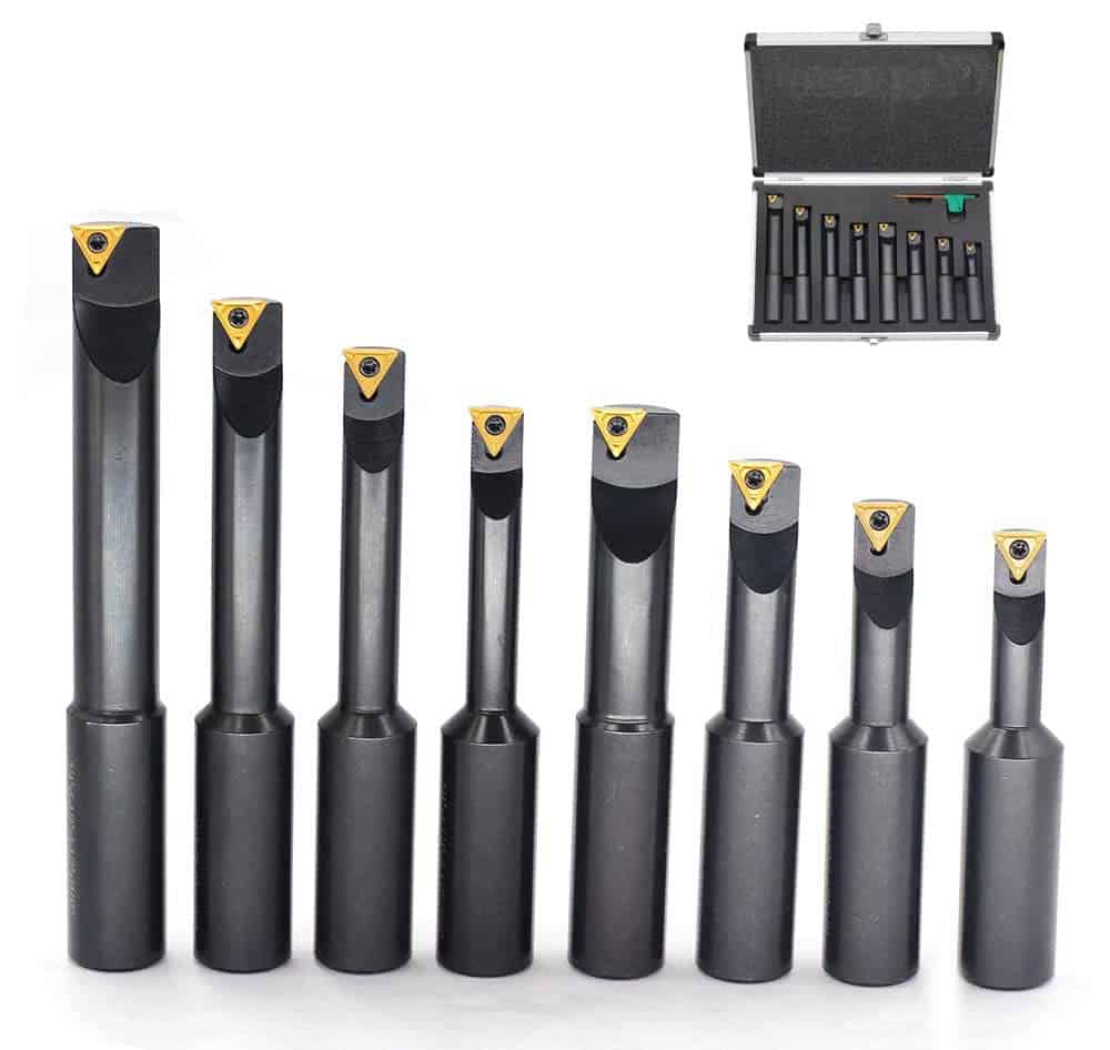

Types and Uses of Boring Bars
HSS
Carbide
Coolant Through Solid Carbide Boring Bars
Dampened Boring Bars
Description
Boring Bars made of high speed steel.
Boring Bars made of Tungsten Carbide
Carbide Boring bars that have through coolant passages.
Carbide Boring Bars that include vibration dampening features.
HSS
Carbide
Uses
Low end jobs that don’t involve too much bar overhang. HSS will deflect excessively if hung more than 3-4x their diameter.
General Purpose. Carbide can be hung up to 7-8x their diameter without excessive deflection
Used to improve surface finish and to faciliate chip clearance in deep bores. Also used for materials that are more difficult to keep cool such as stainless, nickel alloys, and titanium.
Use whenever vibration or machine chatter is hindering productivity. Longer length to diameter ratios are particularly prone to chatter.

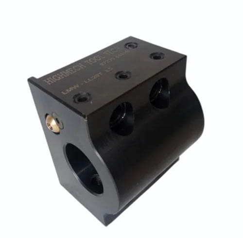

Boring Bar Holder Types for Turning
Sleeve Type Boring Bar Holder
The sleeve type boring bar holders provide the best clamping and vibration dampening. The screws clamp down on a sleeve the grips the boring bar about its entire circumference.
Set Screw Type Boring Bar Holder
The Set Screw Style Boring Bar Holders are generally inferior in terms of vibration damping and gripping force, but they can be a touch easier to set up. The set screws bear directly against the boring bar, clamping against the side of the hole.
