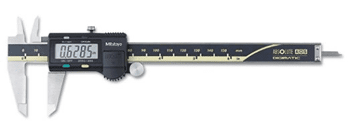

Mitutoyo Advanced Onsite Sensor Digital Caliper, 0 to 6″
I have a couple pairs of Mitutoyo’s excellent AOS (Advanced Onsite Sensor) Digital Calipers, and they have served me well.
Calipers are one of the tools a machinist will use constantly, so get the nice ones. You want minimum 6" and if you can afford them, the 8" are even better.
The 6″ model goes for $115.20 as I am writing this on Amazon. I also have an 8″ model, which goes for $178.75. It’s nice to have a little more range if you need it.
Check our Caliper article for more info.

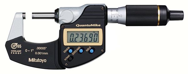

Micrometers
When a pair of calipers just isn’t accurate enough (i.e. need to measure a tolerance that is less than 0.002″), most machinists will turn to a Micrometer Reading for more precision.
Micrometers come in digital, dial, and vernier styles, much like calipers. If you didn't grow up reading the non-digital style, I would skip immediately to the digital. Also, you want the ratchet style thimble to reduce the likelihood of errors through inconsistent tightening.
Mitutoyo Digital Micrometer…
Your next question is, "What size or sizes to get?" Digital Micrometers are expensive machinist tools. I can't imagine buying a big box of them all at once. I'd start with a 0-1" then add Micrometers when you work on projects that require different sizes (or types).
Here's a decent one:
Mitutoyo 293-185, 0 – 1″ X .00005″/0.001mm IP65 QuantuMike Outside Micrometer, No Output, Ratchet Thimble
Amazon Micrometer Deal: $192.02

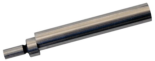

Edge Finder
Yes, every other article on which tools a machinist should buy has you starting out with a "Wiggler" Edge Finder like this one:
Mitutoyo Mechanical Edge Finder. About $12.77 from Amazon...
They work surprisingly well, but this another of those tools a machinist will use often. Why not get an edge finder that is more versatile, faster, and easier to use?

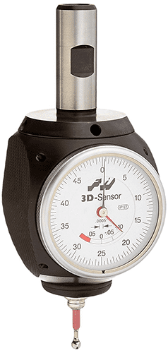

I'm referring to the Haimer 3D "Taster":
Haimer 3D Sensor. About $408.46 on Amazon…
They're not cheap by any stretch, but quality tools never are. The Haimer is well made and a joy to use. Just one thing-be sure to buy some extra tips. It's not a question of "If" but rather "When" will you crash and break the tip.

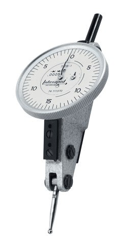

Dial Test Indicator - 0.0005"
Interapid Dial Test Indicators are the best...
A Dial Test Indicator (DTI) one of the tools of choice for many setup tasks such as sweeping the jaws of your milling vise to be sure they're square to the travel of one of the axes.
I’ve tried a bunch of Dial Test Indicators from Starrett, Interapid and others, and I have to say, the Interapid’s are my favorite. They’re Swiss-made tools, and a half-thou Interapid DTI costs about $184.69. Get a half-thou before you get a tenths indicated-they’re a little less sensitive so adjustments are less fiddly.

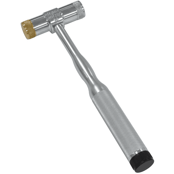

Machinist's Hammer (or Ball Pean)
Over time, a machinist will accumulate a bunch of hammers among their tools. They're not precision instruments per se, but they are used to help ensure precision. That's why you need to start with a hammer you can use to tap things into place for fine adjustment, such as your vise. Yes, you can use a Ball Pean Hammer or a mallet, but a machinist's hammer is much nicer.
Many machinists make hammers during their apprenticeships as students. If you want to buy one, here's a typical example:
If you can afford it, get a deadblow hammer too. These tools are perfect for seating parts in your vise before tightening down hard.

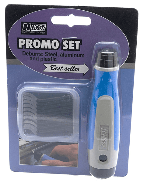

Deburring Tool
Deburring Tools make it easy to slice a nice chamfer into sharp edges. Noga makes a great one:
Just $11 on Amazon as I write this...
BTW, there are lots of slick tools to make the task of deburring faster. Over time most machinists will accumulate a variety of deburring tools. Try this article for information on deburring.

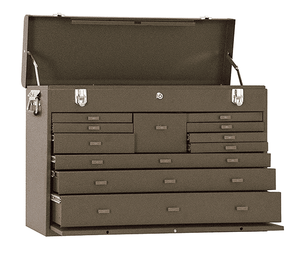

Machinist Toolbox
The most popular toolbox for machinists is the Kennedy:
That Kennedy machinist toolbox is listed for $501 on Amazon as I write this.
Kennedys are built like tanks and have lots of drawers to help organize and separate your tools. But, there's no law that says you have to do what everyone does. You may prefer your favorite rolling tool chest so you have room for expansion.
I'm fascinated by the relatively new crop of modular tool boxes. I like the idea of being able to separate small and easy to carry subsets of my tools to use for specific tasks.

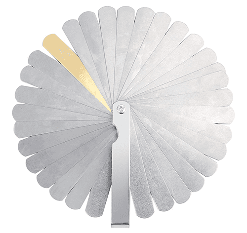

Feeler Gages
Imperial & Metric Feeler Gauge Set. About $5.95 from Amazon…
These tools are handy for lots of things. Get a decent set and stick it in your machinists tool set.

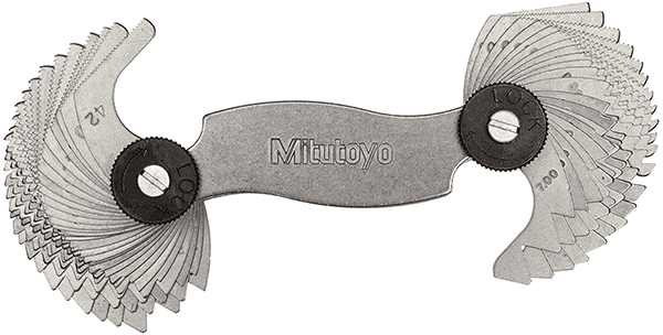

Thread Pitch Gage
Also handy to have on hand:
Mitutoyo Thread Pitch Gauge. About $47 on Amazon…
Each leaf has a set of serrations that match the teeth of the thread to help you decide what the thread pitch is. While threading on the manual lathe, it is reassuring to make a light "ghost" past and check the helix with your thread pitch gauge to make sure you've got it right.

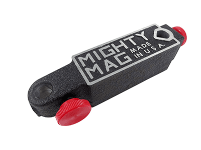

Mighty Mag Base
Remember I said you'd be getting more tools to hold your indicators? Here's one:
Mighty Mag Base: About $17.90 on Amazon...
They're handy for all sorts of situations where the full on mag base with swivel arm is cumbersome and takes to much space. This tool will be handy for those cases.

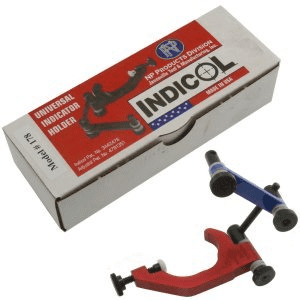

IndiCol
This indicator holder clamps to your machine spindle:
Indicol. About $73.15 on Amazom...
Be sure to match the size to the actual diameter needed to clamp it to your spindle.

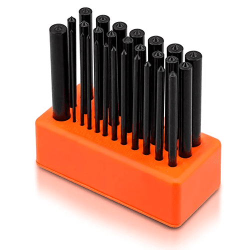

Transfer Punch Set
Transfer punches are really handy for ad hoc layout work, especially repair work with manual machines. They'll be less used for pure CNC manufacture of new parts because you just draw up all the matching holes in CAD.
Still, they're one of those "machinist's tools" that made the light bulb go on when I first discovered them and bought a set. I've used them a lot more than expected over the years, perhaps because I make a lot of parts that have to fit existing parts.
Here's a typical set for a machinist:
They're not costly, about $19.87 on Amazon.

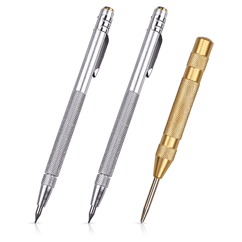

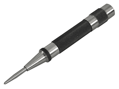

Automatic Punch
Another handy machinist gadget is the Automatic Punch. Basically, you press down on it and it cocks and fires the punch hammer-style to leave a mark on the workpiece. No need to try to grab a hammer with your "third" hand to clobber the punch.
Here's a Starrett:
I'll warn you in advance there are cheaper automatic punches, but I like nice tools. The Starrett is not too bad at $36 on Amazon.

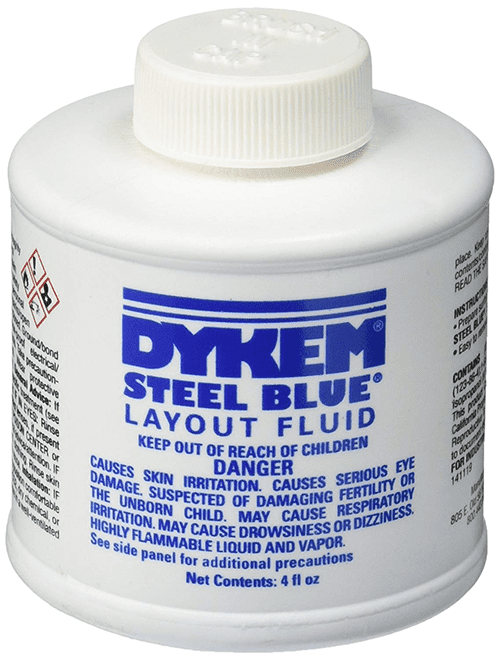

Machinist's Dye and Scribe
While we're dealing with punching and marking, you might want to add a little jar of Dychem Machinist's Dye to your machinist tools set:
Paint it on your metal workpiece and it makes it instantly easier to see scribed lines and marks. I find the blue is higher contrast than the red, but either will work.
While you're at it, grab a nice scribe set:
It's another $14.98 from Amazon. BTW, the final crowning touch in marking tools is a height gage and surface plate (see below) for precision scribing and layout on your workpiece.

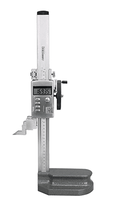

Height Gage and Surface Plate
This pair is going to set you back a bit, but they will seriously upgrade your measuring and layout tools to a higher level of precision. They're also handy for reverse engineering, for example for repair work.

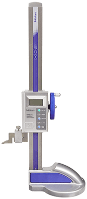

Most all the other tools are pocket sized and easily fit into your tool chest. But a height gauge and surface plate need a little more breathing room. Make sure you will have a spot for them or delay purchase until you do.
First up is the height gage. I have two choices. I notice this 12" Mitutoyo is on sale for a great price ($573.49) on Amazon:
That's a really nice 12" height gage, but maybe more than some will want to spend on tools. For a little less, you can get this 12" digital height gage:
This Accusize Gage is $358.40 on Amazon as I write this.

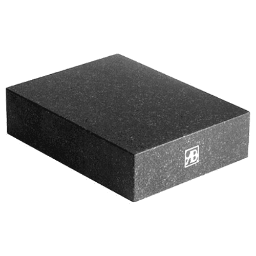

You'll also need a granite surface plate for your height gage. This is a Grade A 18 x 24" surface plate:
For more on how to use a height gage and surface plate, check out our guide.

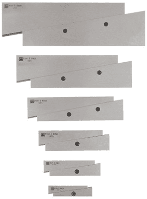

Adjustable Parallels
Adjustable Parallels frequently come in handy. Use them to extract a dimension from an inside area, bring them out, and measure their width easily, for example.
This is a nice Brown and Sharpe set for $158.85 on Amazon.

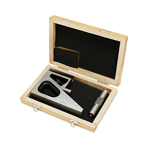

Planer Gage
The Big Brother but slightly different than adjustable parallels is called a "Planer Gage".
This DBM Planar Gage is a little over $60 on Amazon.

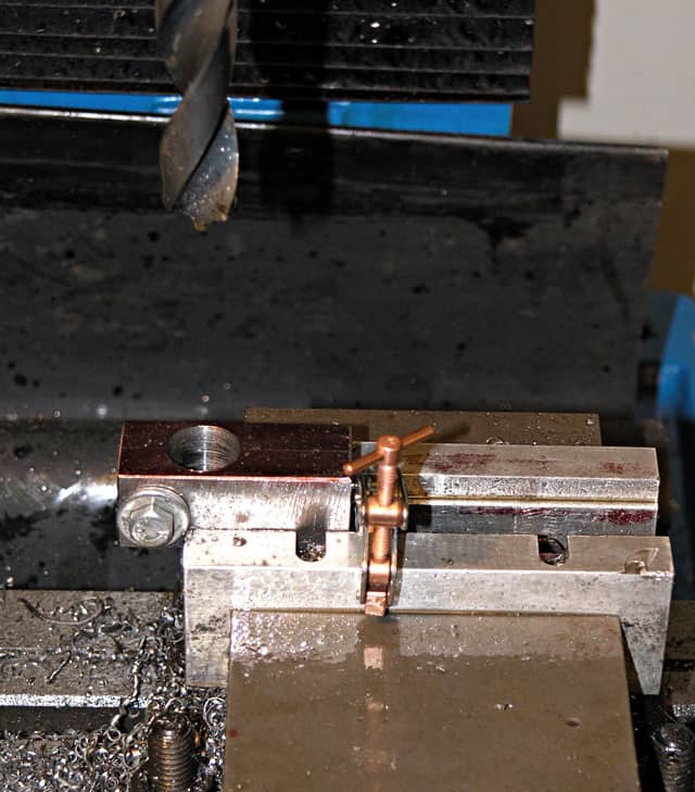

Kant-Twist Clamps in all Sizes
Kant-Twist Clamps are the best tools ever when it comes to clamping. They come in handy in all sorts of ways. For example, as an improvised vise stop:
Next time you see them on sale, grab a bunch and stick them in your tool box.
BTW, next time you have a little extra time, make yourself a nicer vise stop. You'll use it constantly and it is worth the trouble to have a nice one. Here's a Kurt vise stop I made to give you an idea:

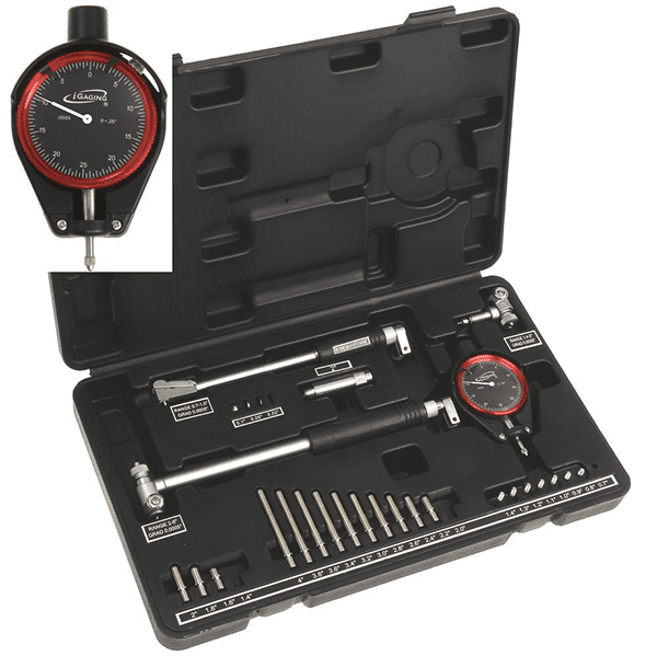

Dial Bore Gages
Measuring Bores is hard. A good machinist can do it with Telescoping Gages, but those machinist tools require a little touch. If I am particularly concerned about a bore, I will often make a go/no-go plug gage for the job. But for sheer convenience, it's hard to beat Dial Bore Gages:
The problem is they are expensive tools. That set pictured above is a good deal-0.7 - 6" bores for $109.95 on Amazon (think that's a special deal). I have heard iGaging makes decent tools, but haven't tried them myself. The equivalent Mitutoyo set is gorgeous but costs $750 and that's on sale for a special Black Friday price!

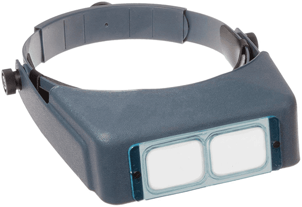

OptiVisor
If you work on small parts, but have never tried an OptiVisor, you're in for a treat:
They're comfortable and the magnification makes them great for tired old eyes like mine. But you can peer under them or flip them up to see without magnification too.
Best of all, they're inexpensive at $41.98 on Amazon.
I find my OptiVisors indispensable tools for my arsenal.
