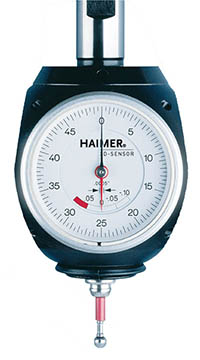

A black dial indicator with a white face and red pointer, featuring black numbers and the logo "HAIMER" at the top.
Check your setup first if you're having issues...

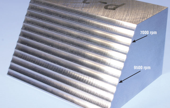

Chatter is repeatable, and there are well understood techniques to eliminate it...
Rob did notice that in all the prior jobs, there was a loud squeal of chatter at one point.  He'd heard that too much chatter can literally shake a tool loose and wondered if that wasn't what was plaguing his collet.  Unfortunately, he was all out of options.  It was time to find a strategy that just could not fail.
The pocket he was cutting was deep-1.25" with a 5/16" end mill.  The chatter was probably due to rigidity being a problem on such a long tool stickout to get to the bottom of the pocket.  Chatter is repeatable, and there are well understood techniques to get rid of chatter, but Rob was out of time and options.  He needed to hit on a strategy that would work right the first time and every time thereafter.

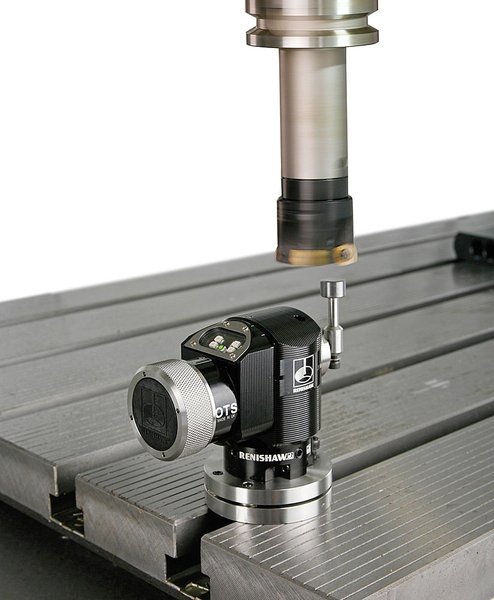

A tool setter for CNC machining centers with a black device and silver knob on a metal table.
This tool touch setter will measure tool diameter as well as length-critical for holding tight tolerances!
BTW, it surprises a lot of newcomers to learn that the tolerances on endmill diameters may not be that tight unless you're paying through the nose.  It is often important to account for variances in cutter diameter to hold tight tolerances.  This can be done by measuring the diameter in an offline toolsetter, adjusting for it with a tool touchsetter mounted on the machine (assuming it can measure both tool length and diameter), or by simply cutting a test and measuring the result.  The latter is the most accurate because it accounts for things like tool deflection and runout.

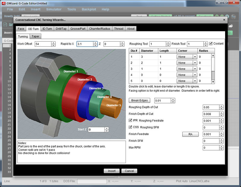

Use G-Wizard Editor's Conversational CNC to write the G-code for you...
It's common practice with CNC Lathes to make trial cuts part of any long-running job.  You load a new bar (or bars) in the bar feeder, and you run a set of trial cuts.  These cuts don't have to include the whole part, just a simplified version that has all the key dimensions with tight tolerances represented.  You may also just run one part too if it is fast.
So, the operator runs the job for the trial cuts.  He measures to determine how far out of tolerance the key features of the part are.  Then he makes adjustments based on the measurements and sets the job in motion to make the rest of the parts.  He can use wear offsets or any of the other methods described.
Say you are not comfortable with the other methods, but you have made trial cuts and know where the problems are.  You could use a Conversational Wizard like the one shown above to make a two-part program like our guy Rob did.  Do the roughing in the first part.  Measure the key dimensions and program finishing passes using the Conversational CNC so the diameters and lengths are adjusted with a finish pass that's just right.

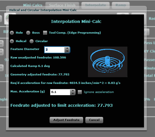

CNCCookbook.com Interpolation Mini-Calc tool screenshot with black background and white text settings for interpolation.
G-Wizard's Helical Interpolation Mini-Calc will adjust feedrate for machine acceleration limits...
Machinists often find they have to slow down on interpolated holes to maintain accuracy.  This may be due to the acceleration limits of their machine.  We've all seen pictures of the astronaut training centrifuge, right?  Going around in a circle creates significant acceleration forces.  If your machine's servos (or steppers) can't accelerate fast enough, that hole won't be round or the right diameter.
G-Wizard Calculator has a special function to help compensate for acceleration by slowing feeds appropriately.

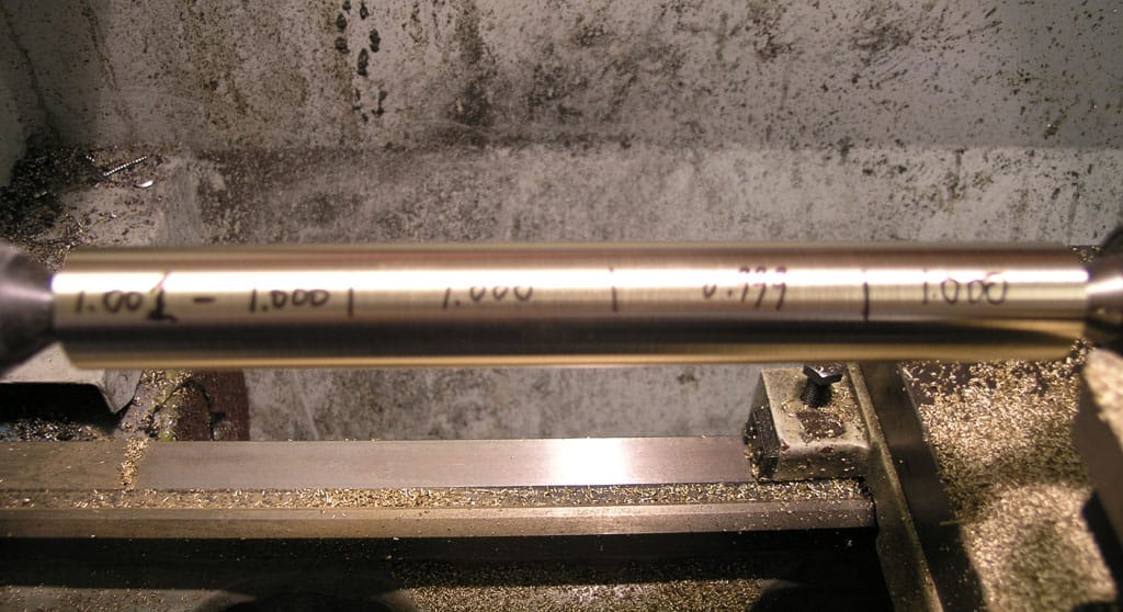

Adjusting for Taper "Zones" on a manual lathe...
Taper is a fact of life in real machine tools.  Whether you're trying to machine a (nearly) ideal cylinder or trying to match a given taper to very tight tolerances, you will probably need to adjust.
I remember adjusting for taper years ago on a manual lathe.  I had it dialed in as best I could, but was still out of tolerance.  So I turned a trial diameter at one end, turned the same diameter at the other, and measured the difference.  Then, when I drew some lines with a Sharpie on the cylinder to identify zones where I needed to adjust.  I baby-sat the compound and turned the dial just a little bit at each zone to balance out the taper.
Bingo!
My part was in tolerance!
On a CNC, you can turn tapers because the lathe can make compound motions (like turning more than one handwheel at the same time on a manual machine).  So, if you measure excessive taper, you can program around it.

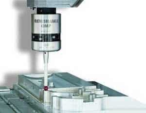

Precision measurement tool, 3D touch probe.
Digital probes: the key to automating in-process inspection techniques...
As you've no doubt concluded, these adjustments can pretty much all be automated and programmed into G-code if we can measure the needed corrections automatically.  The trick to that is 3D touch probing.  I'm not going to try to delve into all those details here, but suffice to say these are powerful techniques.  Companies like Renishaw, for example, use them to dramatically increase the precision of their machining work.
Lots of folks are doing this kind of thing.  See our article 37 things you can do with G-code programming that you can't with CAM for some ideas.  See also our survey results for CNC Probes and Toolsetters to get an idea how widespread this kind of thing is.
