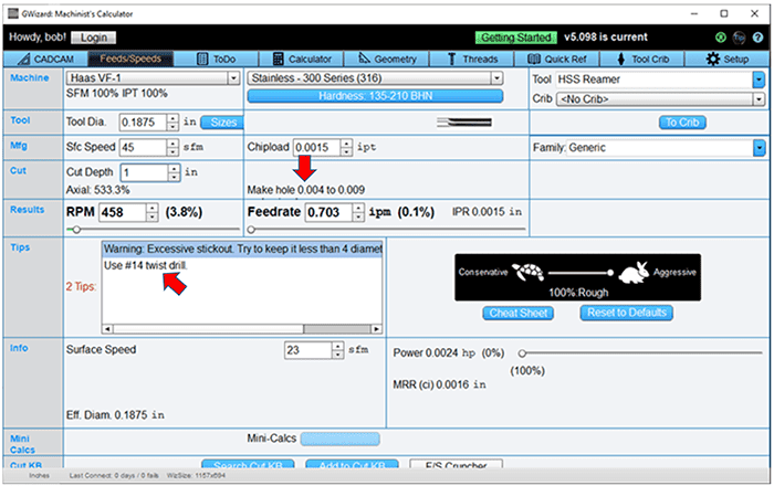

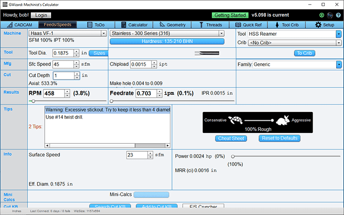

Here's what G-Wizard would suggest for reamer speeds and feeds with a 3/16" HSS Reamer in 300 series stainless, which was the question in the post:
A 3/16" reamer going 1" deep in 304 stainless should run 458 rpm and 2.75 ipm feed. Chipload is 0.0015"

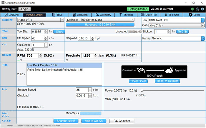

For comparison, here is the same cut with a 3/16" HSS Twist Drill:
Twist drill is 703 rpm (a little less than 2x the reamer), and 1.863 ipm (reamer is feeding a little faster)...
Okay, those numbers are neither 1/2 nor 1/3, though the reamer is spinning close to 1/2 the twist drill, and the reamer feed is faster. What gives?
Well, this is another reason to use a calculator instead of a rule of thumb. There's more at work here than a rule of thumb can account for. For example, it gets harder for a twist drill to extract chips the deeper the hole. Reamers don't even try to extract chips-they have straight flutes and don't produce many chips if a large enough pilot hole is provided. Hence, the twist drill needs to behave more and more differently than the rule of thumb the deeper the hole goes. In this case, we're quite deep-1" is 5.3 diameters deep. I made the hole deep just to make the point.

There was recently some back and forth on CNCZone about reamer hole sizes, and I felt like it would be a good time to throw out that G-Wizard tells you the recommended guidelines for how far undersized to make your holes before reaming:
G-Wizard says to make the hole 0.010 - 0.025" undersized for a 1/2" reamer, and it tells you the closest twist drill size in that range...
Did you notice that down in the Tips area (right above the Tortoise and Hare), G-Wizard tells you the right twist drill size?

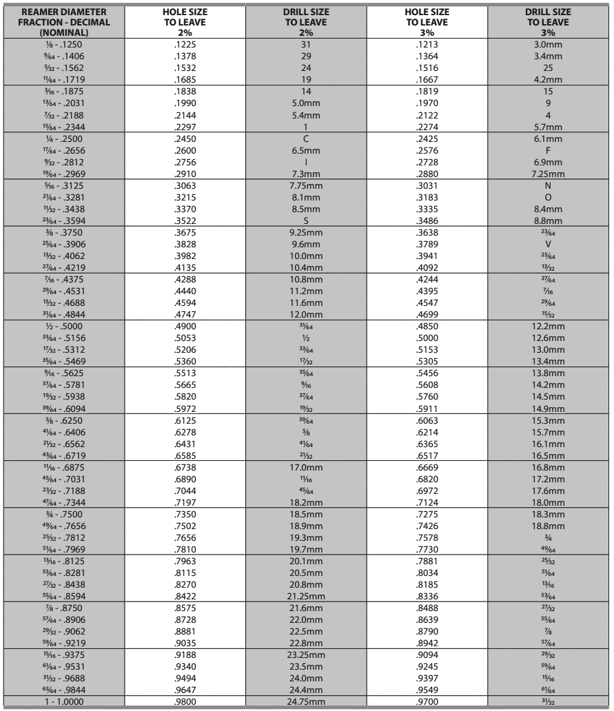

Pre-ream Drill Size Chart
The hole that will be reamed must first be drilled to an undersized diameter. Typically, the rule of thumb is to keep 0.010" to 0.015" material after drilling for the reamer to remove. Very small diameters, say 1/32" or less, should have 0.003" to 0.006" of material to remove by reaming. Rather than using a fixed range, it is better to use a percentage. Make the hole 2-3% smaller than the reamer's diameter. If conditions are good, you can have the hole be up to 5% smaller than the reamer's diameter.
If the hole is poorly drilled, more material may need to be available to allow the reamer to clean up the hole sufficiently.
One of the most common mistakes using a reamer is to leave insufficient stock for the reamer to cut. If this happens, the reamer will rub instead of cutting which will result in excessive wear, poor tool life, and inability to hold diameter tolerances.
BTW, our G-Wizard Calculator will tell you the hole size as part of a Feeds and Speeds Calculation for Reamers. But, for those who want an old-fashioned chart, here you go:

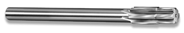

Chucking reamer
The most common type of reamer, pictured at the very top of this article, is a Chucking Reamer.

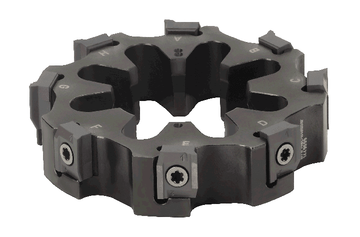

Ring reamers / Cutting Rings
Cutting ring adjustable reamer...
These reamers can use replaceable inserts and they are often expandable to adapt to tool wear.
