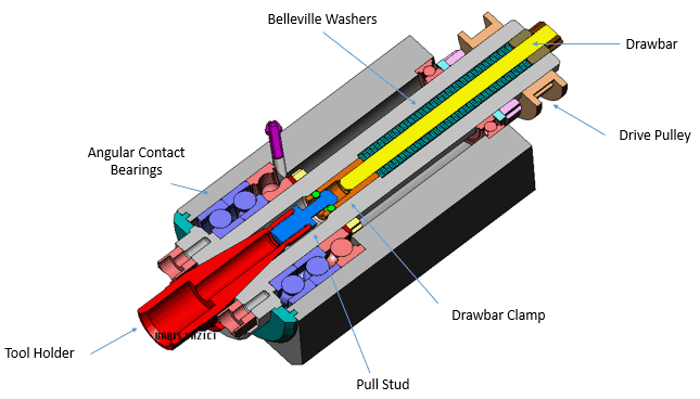

Cartridge Spindles are what pretty much every modern VMC uses.  They're convenient to swap out and rebuild while keeping the machine going, they're more convenient to manufacture than fabricated spindles, and they generally just work well.
Here's a cutaway of a cartridge spindle set up for ATC (Automatic Tool Changer) so you can get an idea of the components:
Mechanical component illustration with labeled parts.
CNC ATC Cartridge Spindle...
Let's go over the role of each component:
Ambitious DIY CNC'ers can design and manufacture their own spindle cartridges, but it's much easier to buy one.  There are high-quality (at least for the DIY market) cartridges available at reasonable prices from outfits like Tormach.
You can even find used cartridge spindles from VMCs in places like eBay.  Just be aware that if they are not in good condition, the bearings alone for a commercial VMC are very expensive to replace.  If the taper is damaged or there is excessive wear requiring re-machining, you'll be looking at a very costly project.

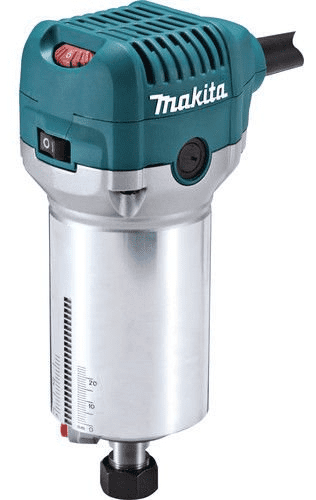

Self-Contained Spindles, especially Trim Routers, are very popular with the DIY CNC Router crowd.  There's a lot to like about a unit like the Makita RT0701CR pictured above:
There are downsides too:

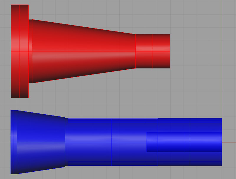

There are a huge number of spindle taper possibilities, so I'll just focus on two common ones for DIY CNC Milling Machines: R8 and BT 30.  Here's a CAD drawing of both:
Two cylindrical shapes with flared ends.
BT-30 at top and R8 at bottom...
And here's a photo of them side-by-side:
Silver metal tool with tapered end and flat base.
R8 on left, BT30 on right...
It should be pretty clear that the BT-30 is beefier.  It's preferred for higher end applications, but the R8 is sufficient for most DIY CNC Milling Machines.  There are many more possibilities, and we go into fair detail about the trade-offs in our Spindle, Drawbar, and Toolchanger article.
