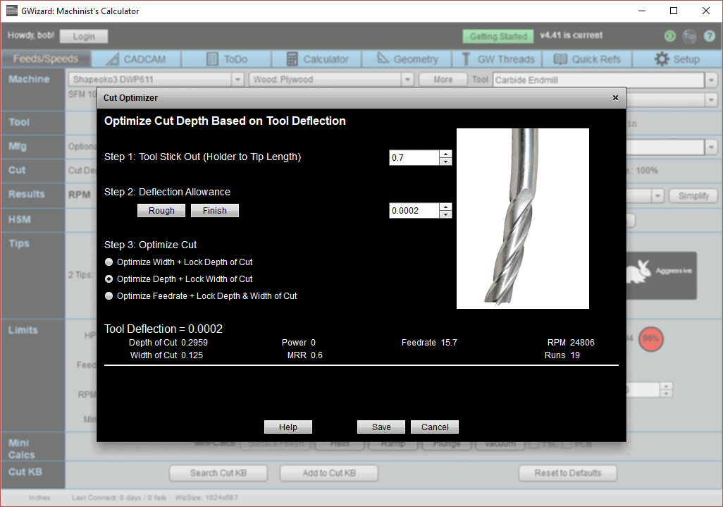

A much more powerful tool for eliminating excess deflection is what we call the "Cut Optimizer":
In Example 3, we'll learn to use the Cut Optimizer.
We'll delve into G-Wizard's Cut Optimizer in our next example. Cut Optimizer will help you to master tool deflection and find the right values for Cut Width and Cut Depth. Click below to check it out.
