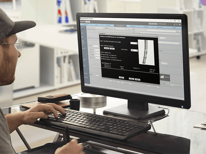

G-Wizard Calculator
We do a terrible job advertising it, but most of G-Wizard Calculator is free. Seriously. You sign up for the free trial, and when that ends, even if you don’t purchase, most of the tabs will go right on working for you. There’s a giant treasure trove of useful calculators, utilities, and reference information there including:
- Fancy scientific calculator with automatic unit conversions and much more.
- The ultimate productivity hack for busy people–the same ToDo list with Pomodoro timer system I use myself to get all this crazy stuff done for CNCCookbook.
- Geometry and Trig Calculators for Right Triangles, Oblique Triangles, Bolt Circles, Dovetails, Tapers, Chamfers, Drilling, Chords, True Position, Points, Turner’s Cubes
- Fits and Tolerances for ISO 286, ANSI B4.2, and DIN 7172
- Thread Database with all the dimensions, tapping drills, and more
- Drill Chart
- Fastener Database with dimensions for Socket Head and Flat Head Cap Screws
- Weights and Volumes for standard metal structural shapes as well as standard lumber sizes. It even handles exotic materials like Tungsten.
- Thermal Expansi0n Calculator
- Electrical Ohms Law Calculator
- Resistor Color Codes
- CNC Servo and Stepper Motor Sizing Calculators
- G- and M-Code Quick Reference
- Hardness Quick Reference with Rockwell (A, B, C, D, 15H, 30H, 45N), Brinell (Std, Hultgren, Tungsten), Vickers, and Shore scales
- Rigidity Calculator to help figure your tool rigidity
- Chatter Calculator to figure the right spindle speed to stop chatter
- Geometric, Dimensioning, and Tolerancing Quick Reference
Phew! I can hardly keep up with all of it myself. I know there a lifetime subscribers who are still delighted at the new things they discover. And we just keep adding more all the time!
All of this will save you time digging through machinery’s handbook or trying to Google for it. It’s all stuff that I use constantly and you will love having it at your fingertips. So what are you waiting for–give the G-Wizard free Trial a try:

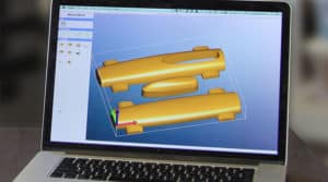

MeshCAM: The world's easiest CAM Software
When beginners first hear about CAM Software, they assume it is almost completely automatic:
- Load a CAD model into it.
- Push a Button.

I dubbed MeshCam the world's easiest CAM Software after trying it the first time. It literally comes closest to that 3-step ideal beginners expect than any of the other CAM programs I've tried. Will it be the last CAM you ever need?
No, you will eventually outgrow it. But you can go very far indeed before doing so. If you just want to get making parts FAST, MeshCam will greatly accelerate your progress compared to something like Fusion 360.
More good news (and a full disclosure): I liked the software so much when I came across it that I begged GRZSoftware to let me resell it. So now you can buy directly from CNCCookbook:

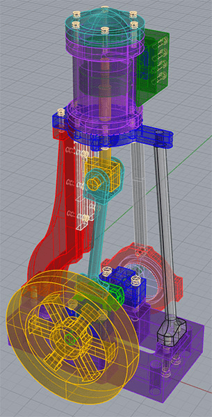

Rhino3D: My favorite CAD Software
Everyone is different when it comes to which CAD or CAM will be easiest and most intuitive for them. That's why I encourage you to try 3, and try them seriously. They're all very hard to learn so it takes time to try 3. But it will be worth it.
My favorite is Rhino3D. I found out through spending time with a lot of packages, that Rhino3D makes me more productive than the other packages. I can bang out CAD models much faster with it, even compared to much more expensive software like Solidworks. I'd encourage you to give it a try.
G-Wizard Calculator: "Lite" Versions
In addition to CAD and CAM, you are going to need help with Feeds and Speeds. CNC'ers tell us it is one of the HARDEST things to master:
I respectively recommend our G-Wizard Calculator to cover that base and make feeds and speeds easy. After all, you have so much to learn about CNC, why not knock out your hardest obstacle up front?
And here's the best part-it's CHEAP!
Get the 1 year version of G-Wizard. It costs little more than a nice end mill.
When the 1 year is over, G-Wizard will become G-Wizard Lite. The ONLY thing that changes is it will have a 2 Horsepower limit on calculations. Most hobbyist CNC Machines are less than that anyway! What a smokin' deal.
