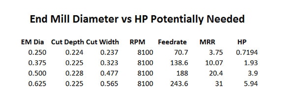

Spindle power goes to Material Removal Rates. The more power, the faster you can remove material, all other things being equal. Things are often not very equal though. Let's take a look at a few different endmill sizes and see how much spindle HP they can effectively utilize and what some of the parameters are that get them to those levels. I'll be using G-Wizard Calculator's CADCAM Wizards to optimize feeds, speeds, cut depth, and cut width, for the data. It's perfect for a quick nearly optimal result:
Endmill Size vs Horsepower Potential...
This data reflects how much horsepower a typical TiAlN coated 3 flute carbide endmill might need in 6061 aluminum. Granted, we're pushing our EM hard, but that's how the Pro's make money. What we can see is that the maximum endmill size that we can productively use to its potential is limited by the spindle power we have available. Some of these numbers are probably pretty surprising to the hobby crowd. A 1/2" EM can probably make productive use of 4 HP if it's available. Anything larger-forget about it unless you've either got more than 5 HP on the spindle or you're just wanting to use very tough tools. They're much more expensive though as size goes up, so probably not worth it.
Endmills are not the only way to gauge spindle power needed. Face mills, Insertable Tooling, and Twist Drills all burn up a lot of spindle power. Let's leave the Indexable Endmills aside. We can see that with less than 5 HP available, you'll need to keep them pretty small diameter anyway. But we might want a nice facemill to surface a block of material. A 2" 4 flute facemill, which is pretty small for the VMC crowd, is limited to taking 50 thousands (0.050") off in a single full width pass on a 1.5 HP machine.
Twist Drills are greedy too. A 1" diameter twist drill going 1" deep in 6061 will need 2.7 HP. If you have less, you'll need to interpolate that hole for best results.

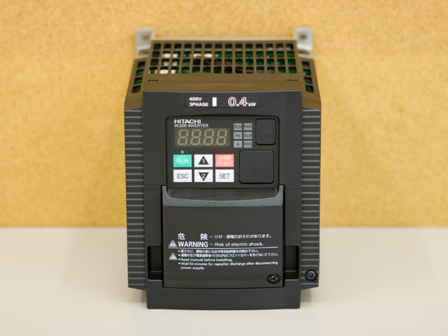

We can get an idea from the above how much spindle power might be needed for various kinds of tooling. Once we've decided on a power level, we'll want to consider VFD's. VFD's, an abbreviation for "Variable Frequency Drive", are the gizmos that go between wall outlet power and your motor to control the motor in various ways. Largely, they do this by changing the frequency of the power. Normal AC motors are rated for 1700 or 3400 rpms when given 60Hz power. If the VFD bumps that up to 120Hz, the motor will run at twice the rpms. VFD's offer many more parameters and advantages. They come in a package that looks much like this one:
Hitachi WJ200 VFD. Photo courtesy of Drives Warehouse...
Prices go up quickly as you increase the amount of horsepower required. You'll find there is also a limited of about 3 HP if you don't have true 3 phase power. For the most part, your issues choosing a VFD will be around price and capacity. You will also want one that can be controlled via whatever method you use to interface to your CNC Controller. This is often a variable voltage signal. There are other desirable characteristics to consider. For example, a sensorless vector drive can deliver 100% at speeds much closer to 0 rpm than less sophisticated drives. This is obviously an advantage for securing the broadest possible speed range.
There are a couple of accessories to look into for your VFD beyond simply interfacing to your controller. One is a ballast resistor pack that can be used to dump power quickly when slowing down the spindle. The allows the spindle to stop or slow down very quickly. The other would be various accessories to be used to reduce the electrical noise produced by the VFD. Noise is often a problem in CNC systems, particularly those of the DIY variety. Be sure to check out our articles on electrical noise to help minimize the likelihood it will be a problem for you.
