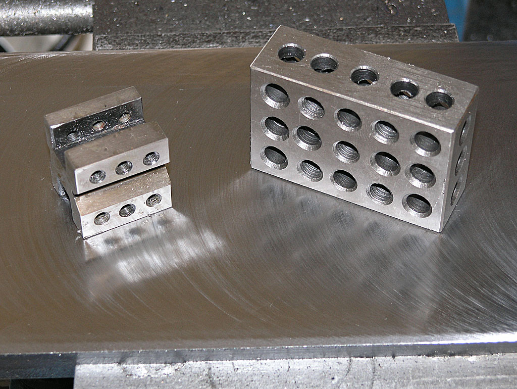

CNC machinists realize the main reason to use a fly cutter is to achieve a very fine surface finish. In most cases, the best finish will be one that can be done in one pass, which implies a large diameter tool and therefore probably not a face mill. OTOH, if you are going to finish the surface in some other way, perhaps not even on a milling machine, the fly cutter may be slower than a face mill at material removal rates.

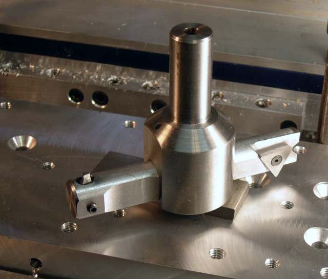

The writer that prompted me to write this post had the right idea–just tell G-Wizard you’ve got a Face mill with only 1 insert. That’s exactly right-fly cutters are just face mills with only 1 cutting edge.

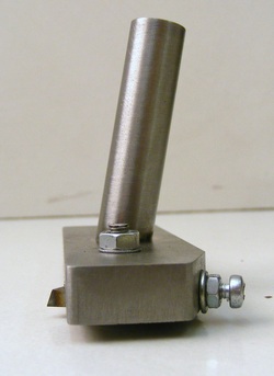

If your fly cutter has a lead angle, the ones pictured both do–the edge is angled, try using the lead angle feature on the Facemill type. If I do all that on G-Wizard, the result is: 1834 rpm @ 12 ipm for a 0.100″ DOC and 1.8″ cut width. That’s not too bad for hogging a surface flat, it’s a half horsepower cut, but there’s way too much chip load for a fine finish. It’s showing 0.0065″ chip load. That’s because it thinks you’ve got a nice facemill with some chunky carbide inserts that can take it. Surface speed is 1440 IPM.

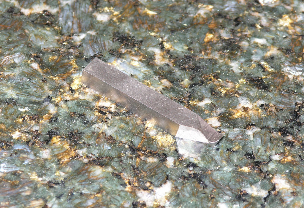

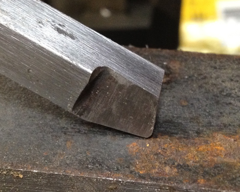

A good manual machinist who wants a great finish on aluminum will grind themselves a razor sharp HSS tool and stick that into the fly cutter. It’ll look something like this:
Note the large radius, sharp edge, and steep positive rake on this HSS Fly Cutter tool…
A tool like that will put a beautiful finish on aluminum, but its edge is too delicate for tougher materials or for the carbide feeds and speeds G-Wizard wants to dish up. Let’s adjust for that with the following steps:

A fly cutter will often produce the best surface finish because they allow you to finish a very wide area in one pass with no overlap marks and the cut has a constant depth. If your face mill has individually adjustable insert heights, you probably won’t see a lot of benefit in a fly cutter, but if not, you can easily convert a facemill to a fly cutter by removing all but one insert, and it is interesting to experiment with the results. Reducing the number of inserts will necessitate a reduction in feedrate, but it may be worth it in terms of improved surface finish.
BTW, you may find that converting a facemill produces a better fly cutter than a purpose made fly cutter of the same size. The reason is that it will be more balanced and so there will be less vibration in the cut. Below I have a number of shop made fly cutters that put the cutter in a round body that is balanced.
Some people swear that the best finish for aluminum is a fly cutter large enough to cut your material in a single pass equipped with a PCD insert of the largest possible radius.
Like most mill cutters, your fly cutter will perform better with positive rake on the cutting tool. I haven’t yet seen any positive rake brazed carbide tools (which seem like the most common thing people stick in their fly cutters), so I suppose you would either need an insert like a CCMT or you’d need to grind your own tool from HSS with some positive rake.

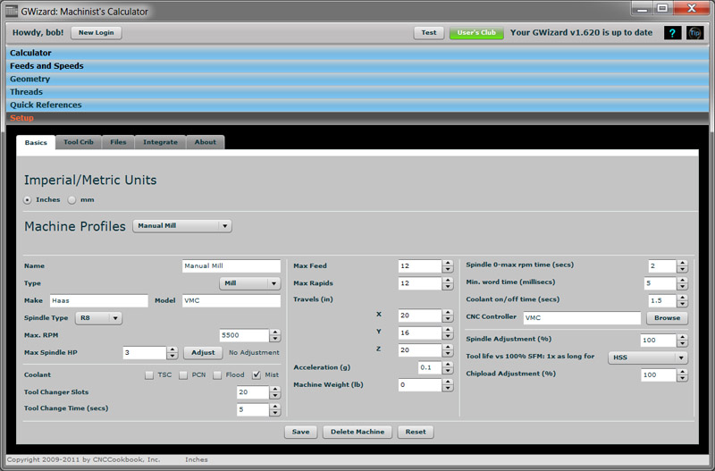

How can G-Wizard help?
Well, let’s go to the Setup page and create a machine profile better suited to our manual machine:
Here’s a Machine Profile suited to a Manual Mill…
I just went in and customized some of the fields to be better suited to a manual mill. I didn’t bother with a lot of it–a manual mill has no toolchanger and we don’t care how fast it accelerates the spindle or which CNC Controller it uses (LOL), those are fields used by the G-Wizard Editor / Simulator. Here are the important points:
– Manual mills usually have a slower spindle rpm, so be sure to set that up. I used 5500 rpm.
– They have lower horsepower and use a spindle taper like R8
– No TSC (through spindle coolant), PCN (programmable coolant nozzle), and if they have flood, it is not strong and might as well be mist.
– Perhaps most important: set the feedrate based on how fast you can crank or how fast your power feed will allow! I used 12 IPM, which is 2 turns a second on a handwheel where 10 turns is an inch.
If we go back to the Feeds and Speeds calculator with that profile, we’ll see that G-Wizard has adjusted to the machine’s capabilities. Our 5500 rpm / 78 IPM cut is now a 3800 rpm / 12 IPM cut. That’s manageable! And, you’ll note the chip load will be 0.0011″. What G-Wizard has done is to try to balance all the factors and get the required feedrate down by slowing the spindle (good for tool life too!) and allowing the recommended 0.004″ chip load to fall as low as 0.0011″.

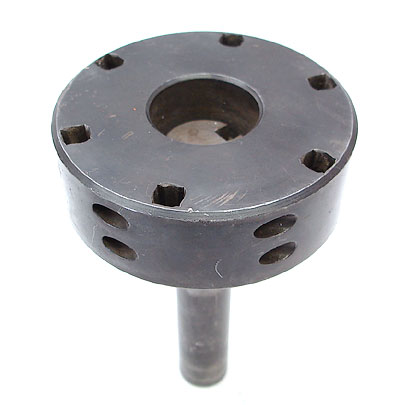

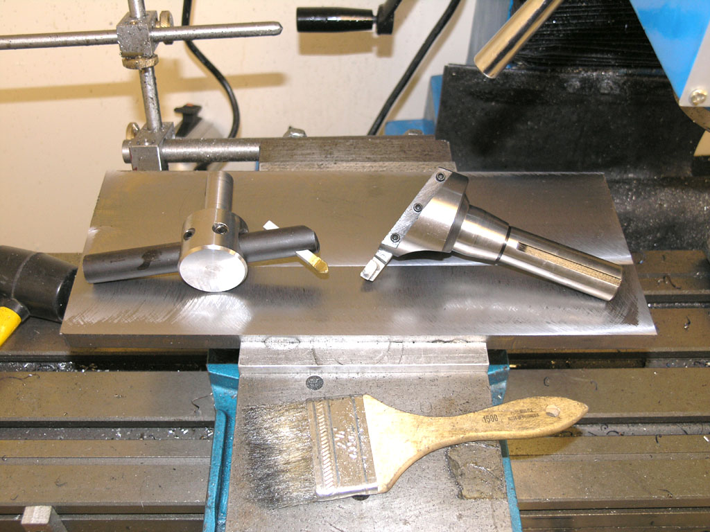

Fly Cutter Geometry
The trick with fly cutter geometry is converting the geometry of an appropriate lathe tool to behave given the geometry of how the fly cutter will engage the workpiece. There's no use talking about it, as it's a very visual thing. Speaking of which, here are a bunch of fly cutter geometry pictures:
Not bad, but the point needs a big radius and more positive rake...
This fly cutter has a honkin' big radius...
These fly cutters are intended to use a geometry created by just grinding an angle on a piece of HSS round, for example, from another cutter that was broken. There's no positive rake, but there is clearance from the angle and a big radius so the geometry is not bad. Note: The center drill is just a placeholder and is not being used as a cutter!
This one is very close, but the face is vertical and should tilt back away from us to create positive rake. The radius is about the minimum you'd want, but fine. Most people make the radius way too small...

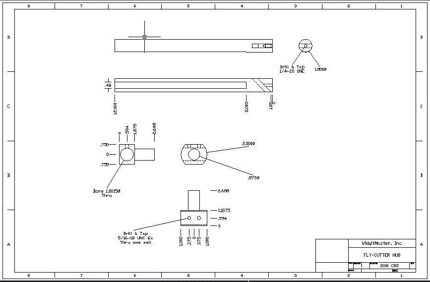

Ideal fly cutter geometry for aluminum: big radius and tons of positive rake. This is Widgitmaster's design...
Widgitmaster's Homemade "Really Big" Fly Cutter
Why such a big fly cutter? Widgitmaster likes to finish all surfaces in a single pass to improve the finish. You'll also see him using really large end mills for the same reason in many cases. He remarks that even though they may chatter, it still gives a better finish than multiple passes.
Note that when you increase the size of fly cutter and start swinging a heavier mass around with the spindle, you'd better make sure your machine has more rigidity so it can handle the big cutter successfully.
The head was trammed to an angle, special vise jaws go on the outside of the vise, and look at Widgitmaster's homemade fly cutter!
Here are Widgitmaster's plans to build his fly cutter. I've got to try one of these and see how I like the finish. He takes 0.010" cuts with it. To make the square hole for the tool in the arm he cut it open, slot milled it, Tig welded it back together, and then turned the arm so you couldn't see the weld. Slick!

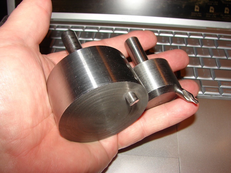

Fly cutting German Style With a Boring Head
Came across this picture recently on a German site with a fl cutter made from a boring head:
Boring head makes for a quick small fly cutter.
I'll bet the tool was ground from an old dull endmill judging from the finish, but I could be wrong about that. I would think a small radius would lead to a nicer finish...

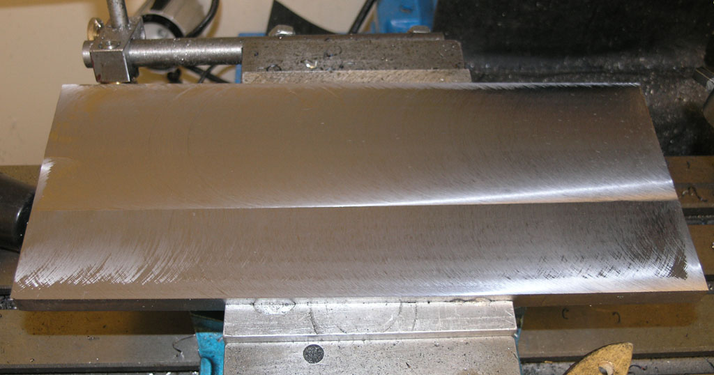

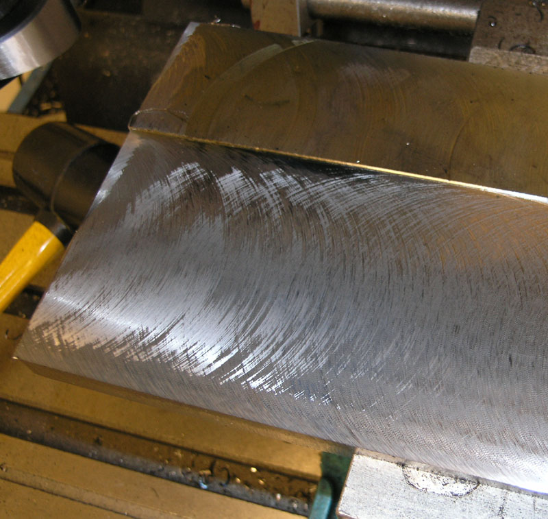

You get the best finish when you can surface with a single pass of the cutter. This becomes difficult on wide plates. It's one reason why fly cutters are popular, aside from being cheap: they cut a wide swath. But not all fly cutters are equal. It's nice to have one that cuts the widest possible swatch, and it's nice to have smaller ones for more rigidity when cutting smaller work pieces. Here are two fly cutters:
Note the fly cutter on the left can be extended to a wide circle...
It takes two passes with the smaller fly cutter, which leaves an ugly line between the passes...
Note how you can see both sides of the fly cutter cutting. If they're even, your mill's head is properly trammed. This one is close, but no cigar!
Using a fly cutter that is wide enough for a single pass is much nicer. Note that it makes the tram issue worse when the cutter arm is longer (visualize the geometry to see why). Now we only see marks from one side cutting...

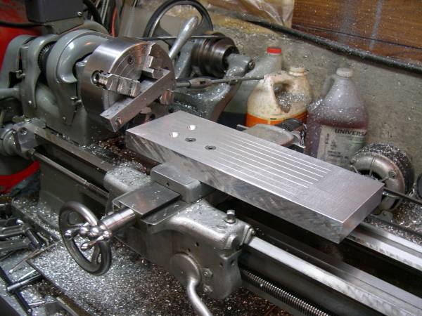

Neat Fly Cutter Tip for Milling in Lathe
You can set up a mill to act like a lathe or a lathe to act like a mill. Necessity is the mother of invention. When you have to get by using their lathe as a mill, it is amazing what can actually be done in this fashion. How about this nifty way to face the end of a big block with a fly cutter in the 4-jaw:
Block bolted to cross slide, fly cutter in the 4-jaw...

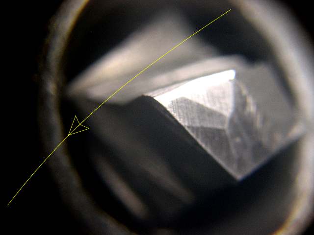

He's got a hand ground HSS cutter on one end and an insert on the other. I don't think he means to cut with both at the same time, they're just options. I like the flat to reduce the chance the bar will slip. I'd also like to try an insert, but I would likely use TCMT's based on my experience making a dovetail cutter. Someone on the thread also suggested a set screw or other feature so that if the bar slips it is captured in the hub and won't go flying across the room.
A close up of the geometry on Evan's hand ground HSS fly cutter bit. It sits vertically, so acts more like a facing cut on a lathe...

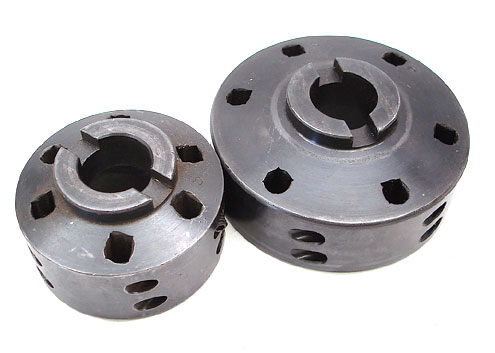

Precision Fly Cutter

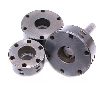

Here is a slightly different kind of fly cutter that came up on eBay the other day as a "Precision Fly Cutter":
I don't know how "precision" they are, but they're interesting. Note how they're designed to fit a shell mill arbor. It's a good idea to give them as much support as possible as they have a lot of leverage on the spindle. I like the idea of using a shell mill arbor as opposed to putting a 3/4" shank on one and trying to stick it into a collet. Not a big fan of multi-cutter fly cutters. If you have more than one cutter in play, you should just use a Face Mill.

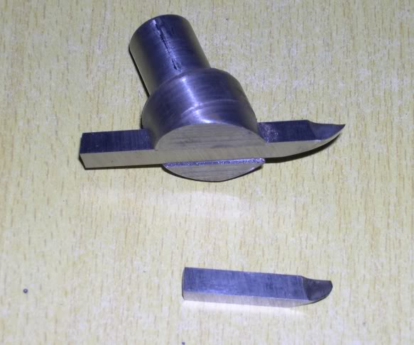

Tangential Tool Fly cutter
Tangential tools are highly thought of for small manual lathes. They're easy to grind and the geometry makes them very rigid. Here is an example of the same principles applied to a fly cutter by the Mike's Workshop Blog:
I'd still want way more radius on the tips than is shown in Mike's article for the best finish.

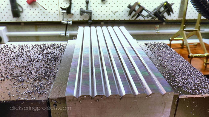

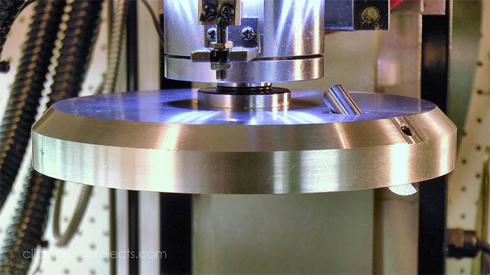

Clickspring's Large Diameter Fly Cutter
Great videos on clockmaking from this site, but he also has a nice write up on a large diameter fly cutter he made:
A couple of thoughts. First, I like the full circle design on these large fly cutters. Keeping the cutter balanced is a good thing, especially if you're after the ultimate surface finish. I would even go so far as to add a little weight to the side opposite the cutter. It should be easy to determine exactly how much is needed by simple balancing the cutter on a knife edge.
Second, he uses a hand ground HSS cutter. I prefer carbide, and it would be pretty easy to adapt a round insert to a design like this to get a big radius for a nice finish. Just notice how large a radius he has ground on that cutter too.
Here's a nice shot of the finish he gets from this fly cutter:

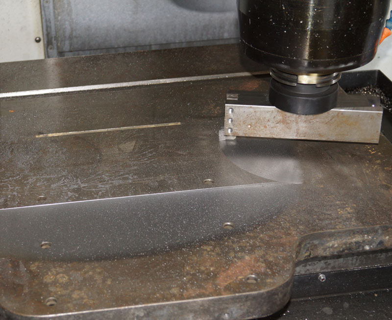

A Fly Cutter May Fit the Toolchanger
All toolchangers have a maximum diameter tool they can accommodate. But here's a trick-if your machine orients the spindle to the same position every tool change, you may be able to fit a fly cutter in a toolchanger that won't allow a similar diameter shell (multi-insert) mill.
The fly cutter goes in with the arm oriented so it points to the center axis of the toolchanger carousel. Depending on your machine, that lets it slide in without interfering with adjacent tools.
