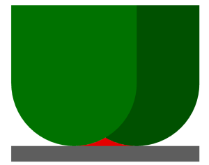

Scalloping
The pictures above show how a toolpath is arranged from above but a side view clearly shows the primary side effect of your stepover choice- scalloping.
A green, scallop-shaped figure with a rounded top and flat bottom.
Scallop shown in red between adjacent passes
The area in red is the part of the stock leftover on the part in between the toolpath offsets. It’s important to understand that these are not good; they are not in the CAD and may need to be removed after machining by sanding or polishing. CNC machinists are almost always trying to reduce the scalloping as much as possible and many man-years of effort have been spent trying to develop toolpath algorithms that minimize them.

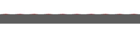

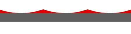

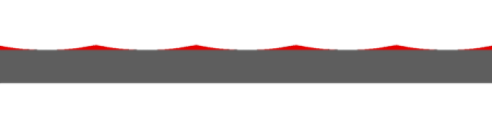

A moment spent looking at the image above illustrates at connection between scallop height and the stepover value- increase one and the other increases as well. In the images below we’ll use a stepover equal to 1/10, 1/5, and 1/3 of the tool diameter to show this correlation. To put real numbers on this, that would be equavalent to a .012, .025, and .042″ stepover for a .125″ ball mill.
Gray bar with red dots at regular intervals.
Stepover =1/10 of diameter
Gray horizontal line with two red peaks.
Stepover =1/5 of diameter
Flat gray line with red triangle.
Stepover =1/3 of diameter
As you can see, the change in quality is so dramatic that you might be tempted to always use the smallest stepover possible.

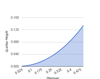

The Sweet Spot
It turns out that there is a point of diminishing returns in the time/quality tradeoff. Below is a graph of scallop height vs stepover that illustrates the effect. The graph has been normalized to a tool diameter of 1.0 so it’s easy to scale it to any tool you happen to be using. (Click on it to see a bigger version)
Machining stepover and scallop height chart.
Scallop vs tool diameter
The important thing to note is the shape of the graph- it tends to flatten out when the stepover goes below about one eighth of the diameter. This means that when you go below this point you’re going to take more time to machine without a proportional gain in finish quality. If you’re machining a steel injection mold then it may still be worth it but you really need to be sure before doing that.

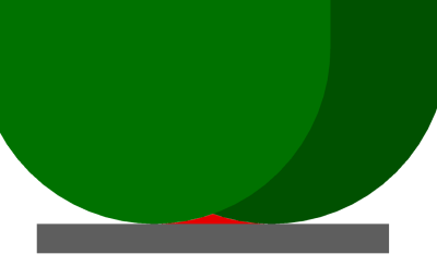

Scallop vs. Tool Diameter

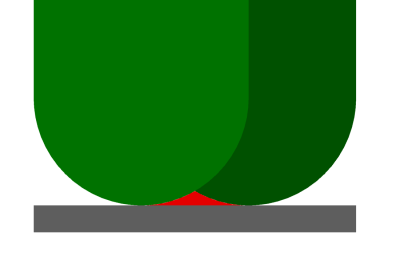

Here’s the other thing we can glean from the math behind the chart above- for a given stepover, a larger tool will give you a smaller scallop. This means that you can get a better finish “for free” if you can use a larger tool. Obviously, this only works if a bigger tool will fit into all of the parts of your geometry but this is one of the few “win-win” things we can do get better results if it does work for your geometry.
Green oval shape on gray rectangular background with curved ends resembling a fish belly shape.
Scallop with a small tool
Green semi-circle with red line representing tool scallop.
Note the reduced scallop when a bigger tool is used even though the stepover is constant.

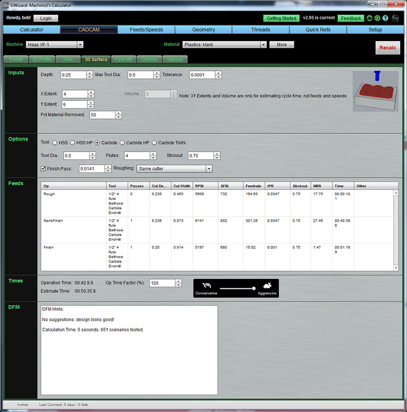

Think of CADCAM Wizard as being an extra employee, who is a pretty good machinist, who you delegate the operation of Feeds/Speeds to.  You tell the CADCAM Wizard some basic high level stuff.  In effect you say, “Hey Joe, I need a machining recipe for a pocket.  The pocket is 2″ by 3″ in 4130 Steel.  Figure out the best parameters for Cut Depth and Cut Width for a roughing pass, and also give me parameters for a finish pass that’s 0.015″.  I need Feeds and Speeds for all that.”  It is important to note that Feeds/Speeds and CADCAM Wizards use exactly the same code to calculate the feeds and speeds, so given all the same inputs, they will return the same answer.
I hope that the idea of having an associate get a very high level direction so they can do the work of producing a detailed cutting recipe makes sense, because that’s exactly what CADCAM Wizards do.  Here is the 3D Surface Wizard:
A screenshot of a 3D surface modeling tool user interface.
Some things to note:
As you can see, the Wizard does a tremendous amount of work for you if you give it just a little information.  When was the last time you tried over 600 scenarios to find the best combination of Cut Width and Cut Depth for you job?  A lot goes on under the covers in the form of Machine Learning Algorithms to make the Wizard’s choice of which 600 scenarios to test very effective.  In fact, it is exponentially better than randomly choosing the scenarios.
If you haven’t tried G-Wizard Calculator’s CADCAM Wizards feature, you should check them out.
Getting a Specific Surface Finish With G-Wizard
Suppose your job calls for a particular surface finish calculated RA or RMS? G-Wizard will make that calculation. Simply tell it you have a ballnosed endmill and the Surface Finish calculator appears at the bottom. Give it a specific scallop height and it will tell you the stepover needed to achieve it as well as the resultant RA and RMS surface finish.
Ballnose end mill surface finish calculator with input fields.
But it gets even better. As you can tell from the article above, the real secret to efficiency is getting the stepover right for roughing versus finishing, all relative to your tool diameter. G-Wizard's CADCAM Wizards will figure out the best numbers for you, or at least a close approximation, automatically. Just select the 3D Profiling toolpath type.
