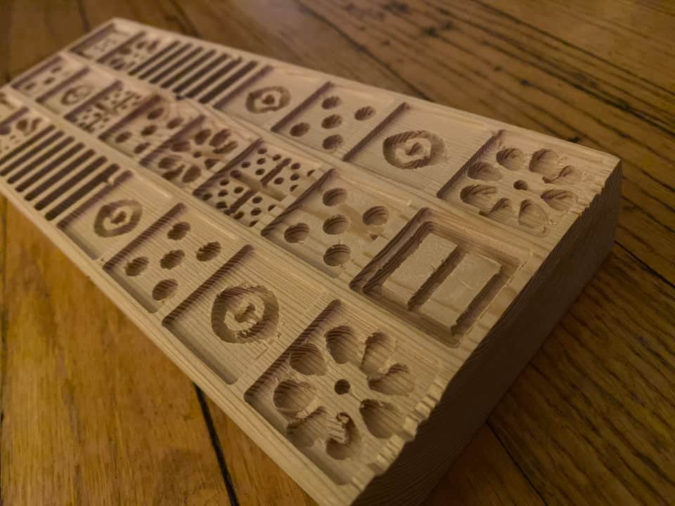

Everyone has dealt with CNC Router Tearout and Splintering when slicing wood at one time or another. Plywood, when subject to CNC Machining, is particularly susceptible to these issues; however, it is not the only material that can experience it. Wood CNC Machines utilizing cutters are universally susceptible to such challenges.
Your CNC Router is sailing along in the cut, the part is just starting to emerge from the stock and it looks awesome. Suddenly, you hear the noise change a bit and a big chunk is splintered or torn out.
Ouch! My beautiful guitar is ruined! What now?
It turns out, there are a variety of things you can do to greatly reduce and even prevent router tearout and splintering.
Router Tearout and Splintering Danger Zones
With apologies to Tom Cruise, powering your cnc router through these Danger Zones is not the right idea. By “Danger Zone”, I mean the conditions where tearout and splintering is most likely. Knowing the Danger Zones will help you to take steps when cutting in these areas to minimize the tearout and splintering.
Danger Zones are anywhere the grain is parallel to the cut. If the cnc cutting machine is going across the grain, that minimizes the risk of tearout, though it may not eliminate it.
The absolute worst is the transition from end grain to edge grain. Curved cuts can make that more likely, so these are further Danger Zones.

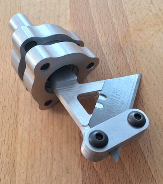

Tip #15: Use a scoring cut to limit splintering
If you score the surface of the wood, splinters will typically stop at the scored line. Use a sharp knife and a ruler. Put the scored line right at the edge you want to cut. A cnc drag knife might even make it possible to automate the scoring on your CNC.
Drag Knife
