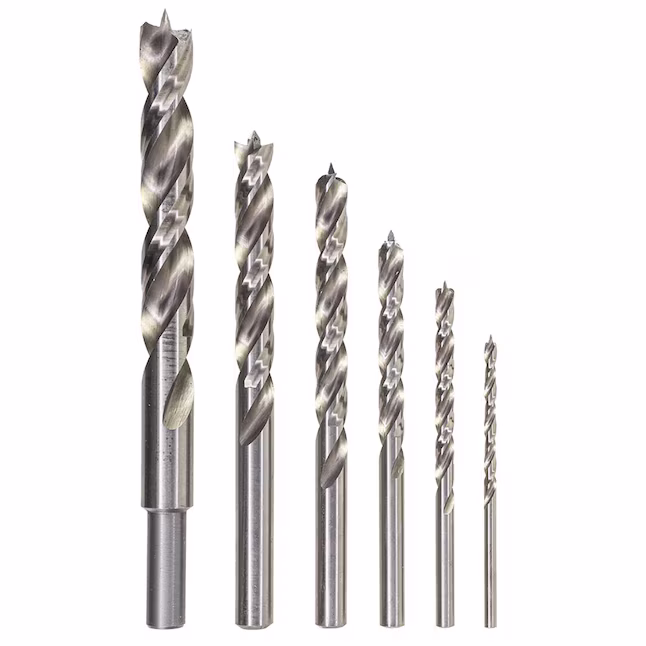

Understanding Brad Point Drill Bits
Let’s explore the world of brad point drill bits, a critical tool for any woodworker striving for accuracy and finesse. Unlike their common counterparts, brad point bits are the maestros of creating clean, straight holes in wood, ensuring your project’s aesthetics aren’t left to chance.
They are cleverly designed to grip the material on contact, minimizing the bit’s tendency to wander and thus keeping your work on point—literally.
Sharp Point
Central to a brad point drill bit is its sharp centering tip, a feature that demands precision. The sharp point bites into the wood, anchoring the bit exactly where you need it, preventing the all-too-common slip and slide. This design is particularly adept at piercing through softwoods, initiating holes with a finesse that spares you the hassle of a center punch.
Simply align the bit with a marked point, and watch as it cuts through the wood grain with precision that leaves nothing but an accurately sized hole and cleanly edged holes.
Outlining Spurs
Encircling the sharp point, the outlining spurs of brad point bits are the unrecognized champions that guarantee a flawless finish. These spurs act as precision cutters, slicing through the wood fibers before the main cutting action begins. They are particularly adept when dealing with hardwoods, cutting cleanly through the robust grains without overheating.
For a pristine entry hole, one should start drilling at a leisurely pace, allowing the spurs to do their job before ramping up the speed.
Cutting Edges
The cutting edges of brad point bits serve a crucial purpose, removing wood chips as you drill, which avoids heat accumulation and leads to a cooler operation. This is especially crucial when you’re working with hardwoods, where overheating can be a concern.
A well-designed brad point bit, like those with deepened chip removal grooves, enhances the drilling efficiency, ensuring that your holes are not only smooth but also remarkably clean.
