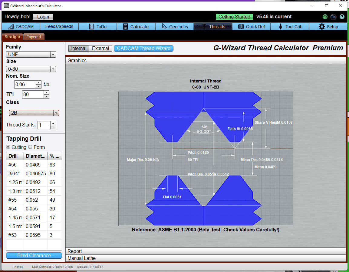

Want to Avoid Breaking Taps?
Of course you want to avoid breaking taps. A broken tap can ruin your whole day. One of the best ways to break fewer of them is to pay attention to thread percentage. Here's the dirty little secret of tapping:
The recommended hole size for tapping is usually not the best.  There is no one perfect size, but you can often do a lot better by considering the thread percentage.
The deal with thread percentage is the recommended tap drill sizes you find in most online charts and on the tap packaging are for 75% threads.  That's conservative from a strength standpoint, but aggressive from the standpoint of over-stressing your tap.  Premium tap makers like  Guhring actually recommend 60% to 70% percentage of thread for most applications because it significantly lowers the torque force required to tap without giving up much thread strength.  That means you're way less likely to break the tap and you're sacrificing very little holding strength.  You get much better tool life by slightly lower percentage of thread.
You can learn a bunch more from our article on tap drill sizes, but now you know enough to greatly reduce your chances of breaking a tap.  It's impossible to optimize tool life without considering the thread percentage and by using proper tapping speeds.  Your cutting tool will thank you if you do both.
