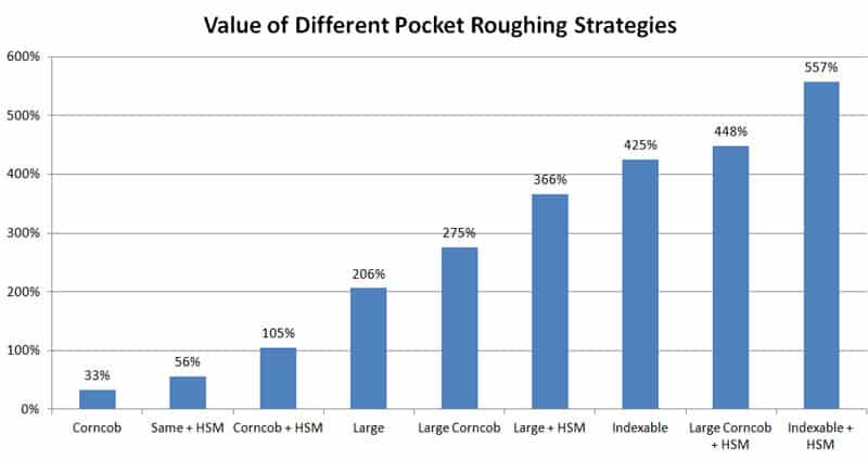

One of the inputs it has is something I call the “Roughing Strategy.”  Assume we want to cut a pocket.  The roughing strategies for pockets are as follows:
Pretty comprehensive, though I will likely add more over time (plunge roughing, anyone?).  I used the Cad Cam Wizard to generate width of cut and depth of that cut for optimal Material Removal Rates (MRR’s), and then I graphed the information to see what effect the different roughing strategies were having.
Here is the graph of the average metal removal rate advantage of each strategy over all materials:
Pocket-roughing-strategy comparison chart displaying bar graphs of different methods.
The best strategy was 5.57x faster than just using the same endmill for finishing and roughing, so there’s definitely gold in them thar hills.  It takes some combination of tooling and CAM features to unleash the full potential for metal removal rates here, so let’s talk about that first.
BTW, the strategies that involve using larger tools for roughing may also deliver longer tool life, as the bigger tools may be quite a bit more robust.

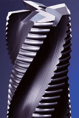

This happens in several ways.  Some tools are purpose made for roughing and can't be used for finished.  The serrated or "corn cob" rougher is a great example:
Metal thread, close-up.
Those serrations break up the chips so they're easier to evacuate.  This type of cutter will buzz through roughing cuts faster than regular solid end mills, and therefore they have higher metal removal rates.

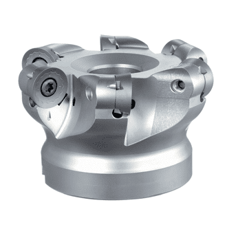

What about indexable tooling?
Another great idea, especially since solid end mills get a lot more expensive to run than indexables as you go up in size.  Plus indexable tools can have much better chip clearance so that they can run more cutting edges so their material removal rates are almost scary.

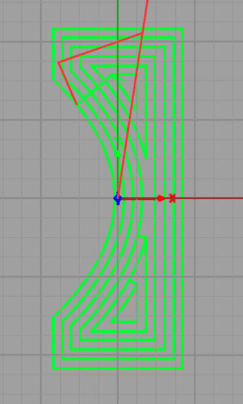

This test focused on two different CAM features that matter for roughing:  HSM Toolpaths and Rest Machining.

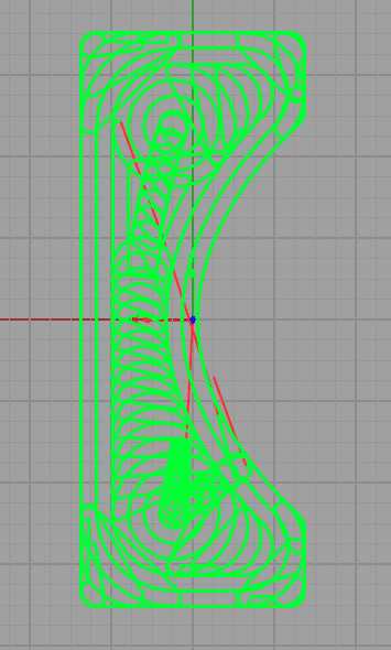

HSM toolpaths allow us to overcome the limitations of plowing into corners where the loads on the tool can double almost instantly.  They do this by using special loopy toolpaths that never go into corners except by peeling their way in a little at a time:
Green outlined rectangle on gray grid background with layered curved edges.
Non-HSM conventional stepover toolpath for pocket roughing…
Green curved CAD drawing on gray grid.
HSM toolpath for pocket roughing…
As you can see, the two toolpath styles are quite different.  Avoiding corners accounts for HSM’s ability to drive the tool through the material so much faster and harder.  The difference can radically improve your job's metal removal rate.

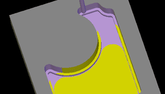

The other CAM roughing feature we considered is Rest Machining.  This is the ability to cut a pocket with a larger roughing tool that can’t clean out all the corners, and then to go back with a smaller tool that can get into all the crevices and do so without recutting the areas that the larger endmill already dealt with.  The small cutter is there to machine “the rest”, hence “Rest Machining.”
Here is a typical example of Rest Machining from OneCNC:
Yellow and purple machining tool with a rounded end.
The yellow areas were roughed out with a larger cutter but it can’t get into the purple areas, which have to be machined by a smaller cutter.

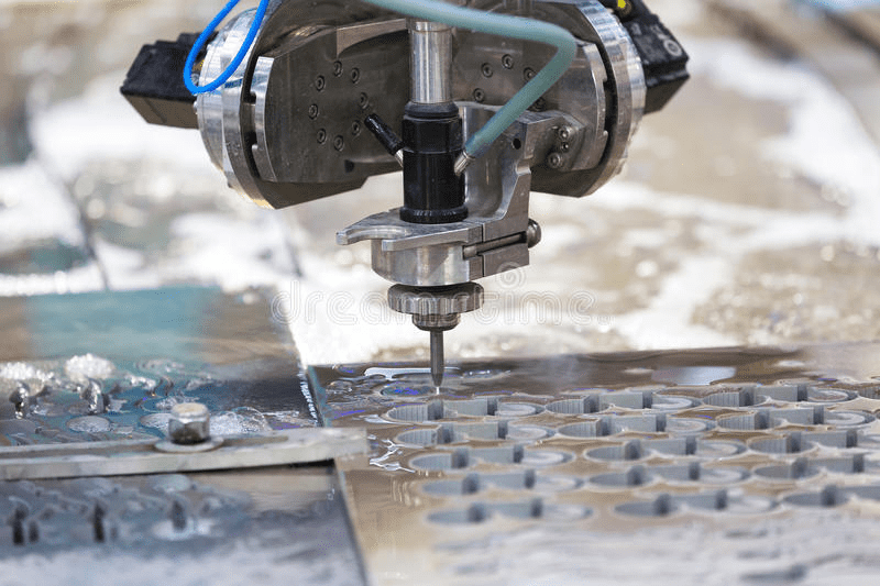

How about a Waterjet or Industrial Laser?
Industrial waterjet cutting machine in action, with blue hose, metal parts, and nozzle.
A typical Waterjet can cut with 0.003 - 0.006" accuracy on parts less than 1" thick.  Thicker parts are less accurate.  Now you've eliminated the roughing step on the Waterjet cut walls altogether.  That brings it down to a finishing pass.
Of course this isn't a panacea.  You can't cut pockets (only through cavities) with a Waterjet or Laser, for example.  But you can eliminate quite a lot of work on the average 2 1/2D part with such a technique.  Perhaps even enough to warrant having a Waterjet or Laser in your own shop to prep parts.
So, the final thing to optimize for your Material Removal Rate and roughing strategy is rough cutting parts before they even go on the CNC Machine.
