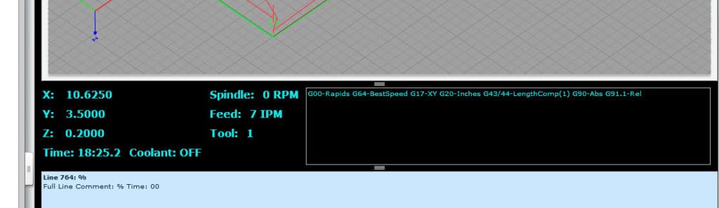

- Graphical backplot makes it easy to see what the tool motions are:

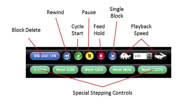

- Transport cluster lets you run your CNC Macro Program simulation:
Change speed, jump ahead to the interesting parts, rewind to see it again, vary playback speed, and more.

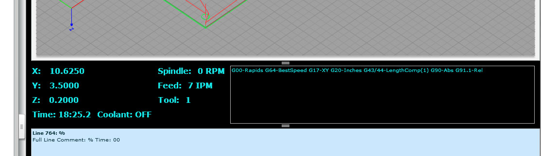

- Simulator Instrument Cluster shows you what the machine is doing. It even shows you what modes are in effect, what macro variables are being accessed, and what their values are.
- Infinite Loop Detection. You can write g-code that just does the same thing over and over. Forever. That's generally a bad thing, but GW Editor will tell you when that's happening and help you sort out what's causing it.
- Variable and Subprogram Listings. Find out which ones are used, current variable values, change values, and more.
