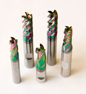

A that point, 99.9% of the time, their problem will boil down to one of 4 things. Note that we're talking about breaking cutters, not wearing them out prematurely. There is an old machinist's adage that if you break a cutter, it is likely due to too much chip load, and if you wear one out prematurely, it is due to too much surface speed. It turns out that each of the 4 things amount to having too much chip load and they happen more often than you'd think.

It's largely a function of how well the cutter can clear the chips out of its way. If they become packed too tightly in the flutes, clearing the chips stops and the cutter is sure to be broken pretty shortly thereafter. All too often I see folks that think chip clearing begins and ends with the flutes of the cutter. Nothing could be further from the truth. That's just the first stage. You need additional means of clearing the chips away from the cut as quickly as possible. Techniques include flood coolant, mist systems, air blasts, and even vacuuming. Whatever method you choose, adopt an attitude of being rabidly paranoid about chip buildup. Get them out and away from the cut as quickly as possible.
