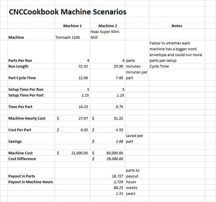

The calculated values are in italics. Our goal is to fill out the variables that drive the calculations, which are:
- Machines: For this first scenario, we're going to compare a Tormach PCNC 1100 against a Haas Super Mini Mill.
- Parts per run: This will be based on each machine's table size, travels, and how many parts you can fit on a fixture or workholding that fits that machine's work envelope. In this case, these two machine hold 4 parts per run.
- Part Cycle Time: The time needed to make one part. You can figure this out using G-Wizard Calculator for Feeds and Speeds and G-Wizard Editor to find the cycle time to run the g-code for one part.
- Setup Time Per Run: This is how long it takes to load and to unload the parts in the fixture. We've put 5 minutes for both since we'll likely use the same fixture in both machines. This number might change radically if one machine had, for example, a pallet change that meant there'd be almost no time spent loading and unloading.
- Machine Hourly Cost: This is what it costs to operate the machine at cost. You can figure it out using G-Wizard Estimator's Machine Hourly Rate Calculator.
- Machine Cost: This cost should be for a fully tooled-up machine, and not just for the machine itself. You'll need toolholders and all that jazz in either case for a new machine.
Given all those inputs, the Machine Scenario spreadsheet will figure out the real cost to make your part on each machine, and then how long it takes the second machine to get ahead of the first in savings.
In this case, we find that if we're making this particular part, it's going to take us 1.31 years before the Super Mini Mill has saved us enough money to offset its additional cost relative to the Tormach. During that time, we'd better have made almost 19,000 of these parts. Or, to put it another way, the machine needed to be 100% busy (busy based on the assumptions used to calculate its costs, which we'll get to shortly) for 68 weeks.

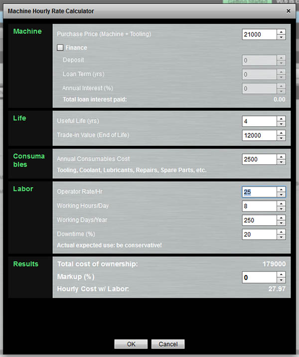

Our G-Wizard Estimator product includes a Machine Hourly Rate Calculator. Here is a screen shot of the Hourly Rate Calculation for the Tormach:
Tormach 1100 Hourly Rate Calculation
The Hourly Rate Calculator is accessed via the Machine Profile in Estimator. It includes a number of different cost factors:
- Purchase Price of the Machine plus Tooling. It's important to include both. I used $21,000 for a fully optioned out Tormach with some toolholders and other goodies.
- If you want to finance the machine rather than buy it outright, that's covered. For this article, I assume we pay cash for both machines.
- The useful life of the machine is important. You'll be depreciating the machine for tax purposes and at some point you may sell it to buy a newer machine. For the Tormach, I assumed a 4 year life thinking a business might be ready to upgrade it after 4 years. For the Haas Super Mini Mill I assumed a 5 year life thinking the more potent machine might hang around a bit longer before upgrade.
- Trade-in value is assumed to be recovered at the end of the machine's life, so it isn't factored into the hourly cost. I often figure trade-in value by looking at asking prices on eBay and other sources. Tormach's hold their value well, so I put down $12,000 as a resale value.
- Consumables would be the tooling, coolant, way oil, repairs, and other similar stuff needed to keep the machine running. I used a lower value for the Tormach ($2500) than the Haas ($5000) since repairs and service are much more expensive on the Haas.
- Labor is an important category. In fact, for both machines, it's actually most of the hourly cost. I'm using a $25/hour operator, and we're assuming the machine runs 8 hours a day, 250 working days a year. We also assume it has 20% down time for repair, preventative maintenance, nothing to do, and so on. That's 5 days a week, 50 weeks a year, with 20% additional down time built in. It's a busy machine, but not a max'ed out machine. If you plan to run multiple shifts or keep your machines busier, those numbers will go up, but they'll actually reduce your hourly costs. The utilization of the machine and labor rate is among the most important parameters leading to hourly cost, so think them through carefully!
- The result includes the ability to markup the machine hourly with a profit margin. For this analysis, I didn't do that.
As you see, the Tormach comes in at $27.97 an hour. If you can charge more than that per hour of work, you can make a profit.

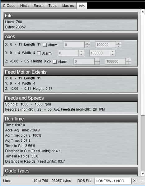

Editor gives you an important advantage when estimating run times: it's capable of factoring in machine acceleration. Here's the info tab:
Note the Run Time block near the bottom. Most of the time you'll see the acceleration-adjusted times are slower than the straight up run times. In the screen shot, adjusting for acceleration added almost a minute of run time. That's not all that unusual, so adjusting for acceleration makes a real difference in getting accurate time estimates.

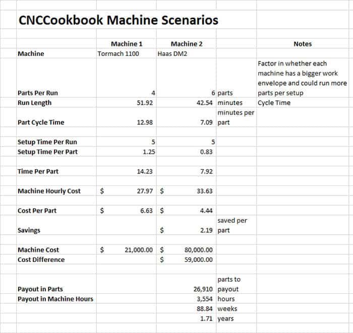

Let's compare the Tormach 1100 to a Haas DM2. The DM2 has a number of advantages:
- Larger table can hold 6 parts to the Tormach's 4.
- 15,000 rpm is even faster than the Super Mini Mill's 10,000 rpm spindle.
- Even faster rapids.
For this part, we wind up with the following worksheet:
As you can see, the payoff is going to be even longer, so the business had better be strong. The problem is that while the new machine is more productive, it's also more expensive, so it's hourly rate is up another few bucks.
What does running 2 shifts a day do to our economics?
If we go from 8 hours a day to 16, the hourly cost on our DM2 goes from $33.63 down to $29.31, which is getting much closer to our Tormach's $27.97. Of course we could run the Tormach for 2 shifts as well, but you see why so many CNC businesses want to run more shifts if they can-it's very beneficial to their economics.
What about financing? With financing, we can afford the fancier machine sooner.
If we finance the Haas DM2 with a $25,000 down payment for 4 years at 6% interest and run the double shift, our hourly cost is $29.82 versus $29.31 paying cash. It doesn't help us with much but cash flow as the interest rate forces us to increase our hourly rate slightly.
