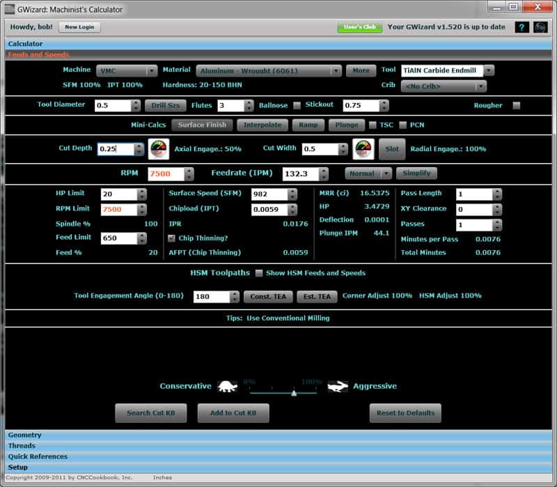

The Mini-Calcs are accessed directly under the Tool Definition (where you specify tool diameter, flutes, and so on):
G-Wizard Mini-Calcs
The three Mini-Calc buttons are right under where you specify Tool Diameter and Flutes…

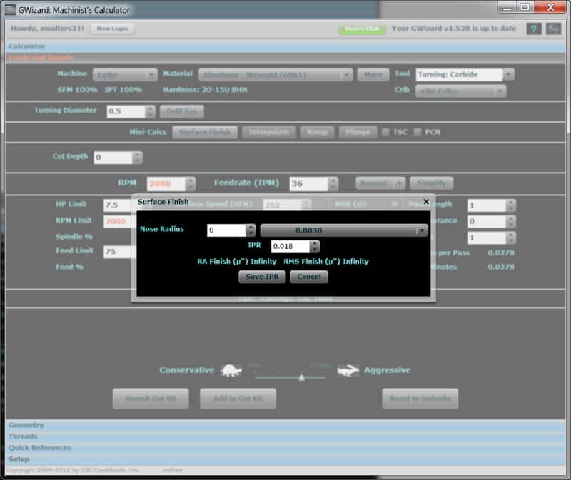

Lathe Surface Finish Calculator
For turning operations, you can pop up a surface finish box to determine feedrates based on desired surface finish given a particular cutter nose radius.
This is one of those features you won’t find if you are using a free simple lathe speed and feed calculator.

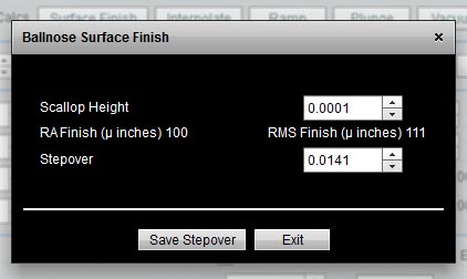

Mill Surface Finish for Ballnose 3D Contouring Calculator
If you’ve selected a mill for your machine and ballnose geometry for the cutter, the Surface Finish mini-calc will help you determine stepover for a particular surface finish:

From the screen shot above you can see I’ve set up an aggressive machining scenario in 6061 aluminum. I’ve got a 1/2″ 3-flute TiAlN Endmill selected and it’s a serrated “corncob” rougher to boot. I want to set up my CAM program to cut a pocket on a part, and I’ve decided my entry to the pocket will be via ramp. I’ll show how to use the Ramp Mini-Calc to solve a couple of interesting problems.
First, let’s say I just plan to ramp down at some “standard” rate, say a 3 degree angle. What should my feeds and speeds be on that ramp? You should adjust your feeds and speeds slightly when ramping because its harder than making a level cut. Let’s say we’ll be cutting our pocket at a 1/2″ depth. Set up for a full slot cut, because the ramp will be descending into bare metal. Let’s also set the depth of cut to be the maximum depth of the ramp in one pass. If we need to go deeper to get down to full cut depth, the ramp will zig zag back and forth. I’ll use a 1/2″ depth of cut at full ramp. Here is the Ramp Mini-Calc with all that keyed in:

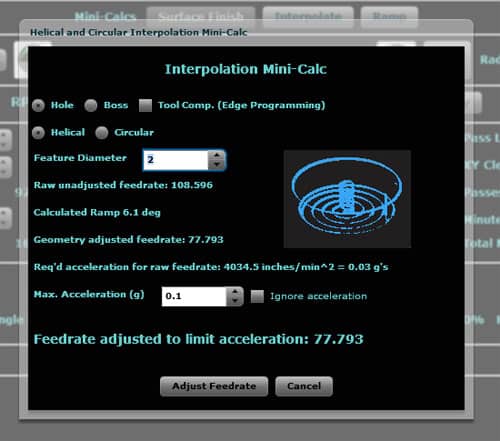

Suppose you want to use the same basic setup to interpolate a 2″ hole. Click on the Interpolate Mini-Calc and here’s what you’ll see:
Helical and Circular Interpolation Calculator
The Helical and Circular Interpolation Mini-Calc…
There’s quite a bit more going on here as you can see. First, you’ll need to specify whether you’re machining a hole or a boss. This determines whether the endmill is going around an ID or an OD diameter. In addition, the checkbox tells whether Tool Comp is in use, in which case the toolpath is the cutting edge rather than center of tool. We also need to tell whether we will be doing a Helical Interpolation (going down the hole in a spiral) or a Circular Interpolation (just machine from center out without changing the Z depth). Lastly, we enter our Feature Diameter, which we said would be a 2″ hole.
Now the Mini-Calc displays a series of intermediate results:
– The raw unadjusted feedrate coming in from G-Wizard is 108.6 IPM again.
– Since we’re doing a Helical Interpolation, there is a ramp angle. We figured it out from the Cut Depth parameter. You could also have used the ramp calculator to go from degrees to cut depth.
– We need to adjust for the geometry of both the ramp and the fact that unless we have tool comp on, our feedrate is based on a radius that is either larger (boss) or smaller (hole) than our feature. As we can see, the geometry adjust feedrate is signicantly different in this case, coming in at 77.8 IPM.
