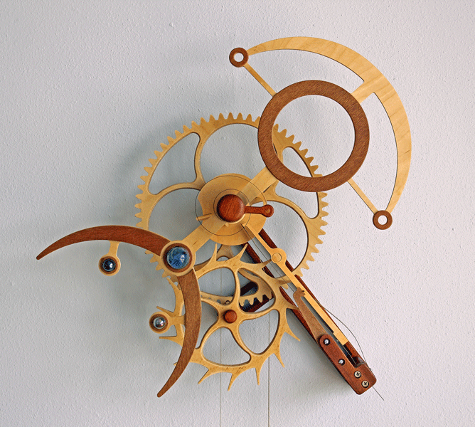

Have you seen those super-nifty wooden clocks where the gears and everything are all made from wood? They are so cool!
If you wanted to design something like that from scratch, we offer software called Gearotic Gear Design that is CAD and CAM for designing gears. It's very cool and a lot of fun to doodle with.
