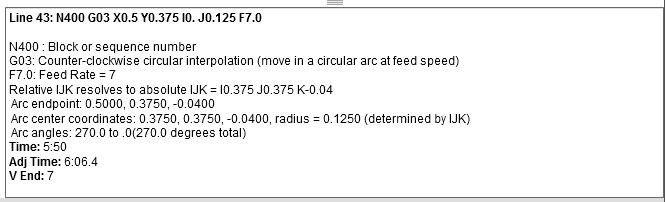

First and foremost is a feature we call Hints. They're more than just Hints though-they spell out everything that is happening in a line of g-code in simple English. There's a Hint right below the backplot that always shows the Hint information for whatever line of g-code the cursor is on. There's also a "Hint" tab that will show you line-by-line Hints instead of listing the g-code. You can find them on the GW Editor screen here:
There's always a Hint for the current cursor position below the Backplot and there's a Hint tab that shows line-by-line Hints...
Here's what a typical Hint looks like for an arc:
A typical Hint for an arc...
At the top is the Line # and the original text of that line in bold face:
Line 43: N400 G03 X0.5 Y0.375 I0.125 F7.0
Directly below is a breakdown of what that line does in English:
N400: Block or sequence number
G03: Counter-clockwise circular interpolation (move in a circular arc at feed speed)
F7.0: Feed Rate = 7
Relative IJK resolves to absolute IJK
Arc End Point, Center Coordinates, Radius, and Angle: There's quite a lot of additional calculated information provided about your arc or other g-code that is often very hard to come by.
Time and Adj Time: These are the time estimates for this line both regular and adjusted for acceleration limits. Acceleration is often the limiting factor.
V End: This tells you what the actual feedrate was by the end of the move. Sometimes there's not enough acceleration available to even get to the commanded feedrate, and it's useful to know when this is happening.
Taken as a group, Hints not only make it easier to understand the g-code if you're not very familiar with g-code, they also tell you all sorts of information (such as the actual location of the arc center or the acceleration adjustments) that's very hard to come by any other way. Even experienced g-code programmers find that information extremely convenient to have around.

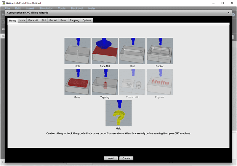

2. Conversational Wizards
G-Wizard Editor includes a free set of Conversational CNC Wizards:

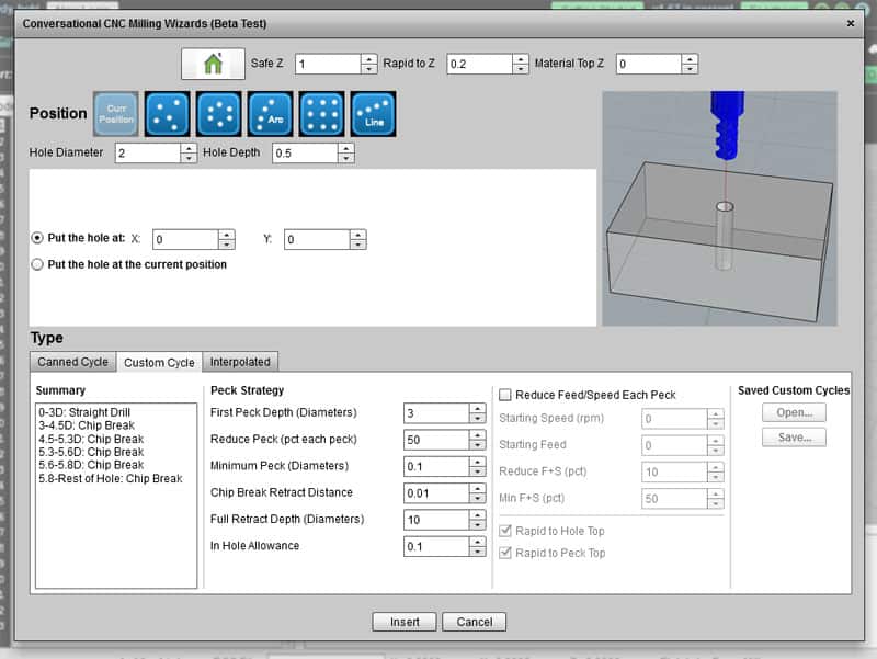

These Conversational Wizards generate g-code on the fly after answering a few basic questions. For example, the Hole Wizard has a comprehensive set of options available for making holes:
Hole Drilling Wizard...
Options for the Hole Wizard include:
- Holes can be made at a particular positions, in a list of arbitrary coordinates, in a bolt circle, along an arc, in a rectangular grid, or in a line at any angle and separation.
- Hole can be made using your machine's canned cycles, our custom Deep Hole Cycle Wizard (pictured above), or using interpolation.
The Deep Hole Cycle is a customizable cycle that gives you access to all the special tricks of the trade when making deep holes. You can decrease the distance between pecks as you get further down the hole, you can switch from quick chip breaking pecks to near full retracts as you get deeper (making sure the bit doesn't clear the hole completely and let chips fall back in, you can reduce feeds and speeds with each peck, and so on.
The Conversational CNC has many uses. If you're manually programming, it can save you a lot of effort to crank out basic operations such as holes and face milling. Or, you could use it to update certain parts of a CAM-generated program. For example, perhaps you'd like to use the Deep Hole Wizard for certain things. Or maybe you're trying to make a simple quick and dirty part without ever having to do a drawing and run your CADCAM software. Conversational Wizards are great for all these tasks.

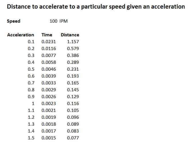

We briefly touched on Machine Acceleration Adjustments in the section above on Hints. Acceleration is one of the dirty little secrets of CNC. Due to acceleration limits, it's entirely possible that the cutter never even gets going as fast as the commanded feedrate. Let's say you want to accelerate from dead stop to 100 IPM. Here's a chart that shows how far the cutter must travel with various machine acceleration limits:
It'll be a rare and fairly expensive machine that can hit the higher accelerations. If you have a more modest machine that's only capable of say, 0.2g of acceleration, the cutter needs more than half an inch to get up to speed. The situation is even worse for arc motions, because the machine acceleration has to work not only to achieve the feedrate, but to fight the centrifugal forces an arc creates.
It's important to understand what's really going on with acceleration for a variety of reasons, not the least of which is getting accurate time estimates for how long an operation will take. Another use for it is to understand which parts of your g-code are not reaching the commanded feedrate. If you expected the cutter to survive and prosper at the commanded feedrate (perhaps because you used our G-Wizard Calculator to figure that feedrate), you're leaving money on the table if you machine can't go that fast. If you need to tune that g-code up for every last ounce of productivity, you'll need to find a way to work around the acceleration limits. One approach would be to increase depth of cut or width of cut in areas that can't get to full feedrate. That way you can keep Material Removal Rates higher and still stay within the acceleration limits of your machine.

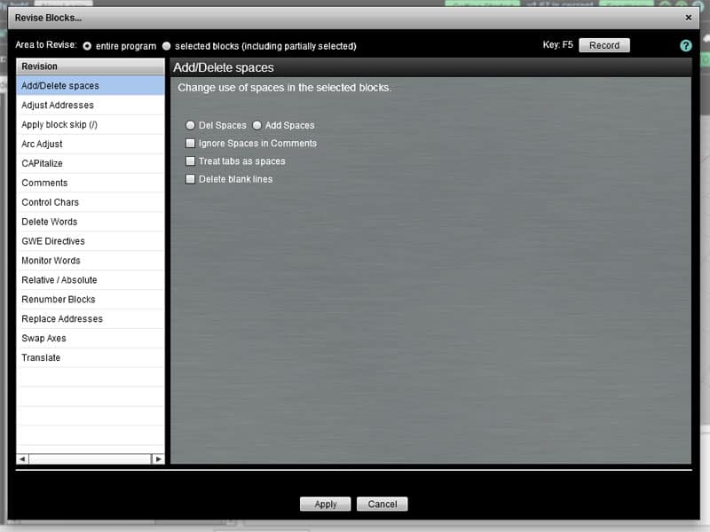

Wouldn't it be great if you had an experienced hand at g-code programming available to edit your code and make changes to it under your guidance? You know what you want, but some of it is just very time consuming to accomplish. That's why we put a feature we call "Revisions" into GW Editor. Think of an editor as revising your code. Revisions are for the same purpose. They take some or all of the code in your g-code program and make an update to it of some kind. There are lots of different Revisions available, here is what the Revisions menu looks like:
G-Code Revisions can make complex transformations on your g-code...
Let's say for example you've used your CADCAM to product a program to do a part. Now you want to be able to call that part from a subprogram, and perhaps you want to do various other transformations to it, for example rotating it so you can call the subprogram a number of times and at different rotations to cut a bunch of these parts out of a plate. One Revision that might be handy is to change that part program to use Relative Addresses instead of Absolute. This way, you move to where you want the part zero to be, call the subprogram, and it is perfectly happy to make a part at the new location.
That's just one of many possible Revisions available to you for your g-code programming.
