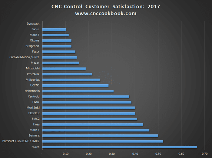

As in 2016, respondents were asked to report their Customer Satisfaction towards their control with the following responses:
  1. It Rocks! (Scored as 1.0)
  2. Works Fine (Scored as 0.0)
  3. Not Very Happy (Scored as -1)
A perfect score would therefore be 1.0, meaning every respondent said, “It Rocks!”
Here are the results:
cnc control customer satisfaction 2017
2017 CNC Control Customer Satisfaction Scores…
At the top of the scoring were Hurco and PathPilot / LinuxCNC.  In recognition of this, we’re awarding them Customer Satisfaction Seals.
Customer Satisfaction Award, Pro Category: Hurco
Hurco ran away with it compared to the other controls, scoring 0.67.  In essence, that means 2/3’s of Hurco respondents said their control rocks.  I haven’t had the pleasure of using a Hurco control, but I know they have a lot of awesome features, especially in the area of Conversational CNC. One user remarked, “Extremely quick on-machine programming, especially for helix and thread mill operations.”

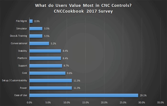

Here’s what our survey respondents told us was most important for them:
What do users value most in CNC Controls?
The runaway best-selling area to focus on is Ease of Use.  Not a big surprise.  Having used a lot of different controls, I can tell you that many are not all that easy to use.
Power and Setup / Customizability are tied for second place.
It’s significant that aside from cost and features, there’s another group that all contribute together to the likelihood users will succeed with their CNC Control:
  • Support:  Can I get the help I need?  This help can come from either the vendor or large online communities.  It’s also a function of whether the control is kept current, or orphaned.
  • Platform:  What about the hardware under the software that is the control?  Is it open?  Is it proprietary, making it expensive and hard to work on?
  • Stability:  Stability was mentioned extremely often in the survey.  A CNC Control is no place for buggy software.
  • Docs & Training:  Somewhat related to support–can I get what I need to help myself become proficient with this control?
If we add all of these elements together, they have a combined score of 29.1%.  That’s tied exactly with ease of use!
When shopping for a control, be sure to look at these intangibles just as much as the sexier features, bells, and whistles associated with a control.

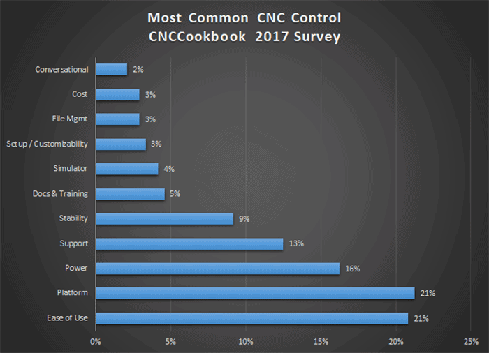

Here were the most common complaints from the survey:
Most common CNC Control complaints…
The number one areas for complaint were Ease of Use and Platform.
Let’s drill down a bit more on the Platform category.  Here are examples of things people said they disliked about the Platform:
  • Buttons on panel wear out too quickly or are too hard to press.
  • No feedrate or spindle speed overrides
  • Keyboard has terrible feel
  • Performance is too dependent on specs of the underlying PC
  • Control is based on Windows.
  • Date in appearance
  • Only runs on old PC’s
  • Screen is too small
  • Hard to get parts for old controls
  • Black and green screen is hard to read
  • Inadequate and too expensive memory
You get the idea what folks have problems with.  And yes, its obvious some of these things are all about legacy controls.  Some are also opinions not well supported by facts.  In the Hobby World, its common to think a control running on Windows must be inferior to one running on LinuxCNC, but there are no end of Pro controls that run great with Windows.
As a matter of fact, our Customer Satisfaction Gold Winner, Hurco, runs on Windows.  A lot of problems with control software or lack of additional hardware motion control can lead to problems that seem Windows-related, but clearly they’re not.
After these two, Power was the next complaint.  Some common complaints included:
  • Inadequate work offsets or other features needed to control the coordinate system.
  • Inability to do web monitoring of the control.  Machine monitoring is one of the big deals our Top Shops survey analysis touched on.
  • Lack of features related to Tool Data Management is another common complaint.
  • Missing features that make shop floor programming easier.  I’m used to Conversational CNC for this, but there are other features that go into this category.
  • Non-standard g-code.  I’ve said it before, but the world would be a better place if every CNC Control could execute Fanuc’s dialect plus added features on top of that.  It’s not that hard to do, but doesn’t even occur to many Control Designers that it’s a good idea.
  • A decent simulator with good backplot is expected in every control by this time.
  • On-machine help and docs are also expected.
That covers a lot of the areas to avoid if you want users to be happy with your CNC Control.
