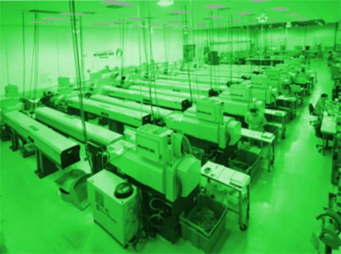

Lights Out Machining: 75% greater likelihood
Lights Out Machining: Huge Advantages But Hard to Achieve…
This is the #1 difference. 64.1% of Top Shops practice Lights Out Machining, and they’re 75% more likely than Other Shops to do so.
If you do the math, it isn’t hard to understand why, so let’s dig in a bit. The single largest cost any of these shops have is people, not machines or tooling. Lights Out lets the machines keep working after the people go home. As such, any parts or work done during Lights Out is free of people charges (almost anyway, there’s the cost to setup the job before the people went home).
That’s a huge financial advantage that’s well worth pursuing. If you’re interested in learning more, we have a couple of great articles on the topic:

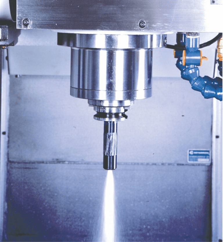

Through Spindle Coolant: Like a Nozzle in your tool’s tip. (Image courtesy of MC Machinery Systems)

At the top of the list is Through-tool coolant and high pressure coolant. Our G-Wizard Feeds and Speeds Calculator is the only F&S Calculator I’m aware of that accounts for these when calculating feeds and speeds, and I am not surprised to learn they’re an important weapon in the arsenal of any Top Shop.
These premium coolant system are not very expensive compared to the overall cost of a CNC machine, but their advantages on cycle time can be quite large.
