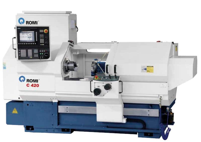

Lathes are somehow fundamental and intuitive machines for many machinists. We have to make a lot of round parts because rotary motion is so common, and round parts are what lathes do. Lathes are simpler to get our heads around many times. There are simpler options for work-holding on lathes than mills. Tooling is often simpler, at least when we're not talking about doing milling on our lathes. There are a lot of different kinds of lathes out there too, some very specialized, some being of general purpose use. For a workshop like this, I envision two different machines. One is great for prototyping work and especially for relatively large scale parts-this workshop needs a classic CNC Toolroom Lathe. You know, the kind that has a big chuck at one end and a tailstock at the other. Ever since playing with a friend's Romi Toolroom Lathe, I've really fallen in love with the whole toolroom lathe concept, and so this workshop will get a Romi. Their C420 is a 17×40 lathe that seems about right for this sort of thing:
Romi C420 17×40 CNC Toolroom Lathe...
Underneath all the covers is a fairly conventional lathe-looks a lot like a nice manual 17×40. But add the CNC and the machine is much more powerful, especially with the Conversational CNC capabilities of either add-on software or the controller on the machine. I wanted to make a part one time that included an R8 taper, and I remember it was total simplicity to do one on the Romi. Haas offers their TL-series lathes which are very similar in concept.

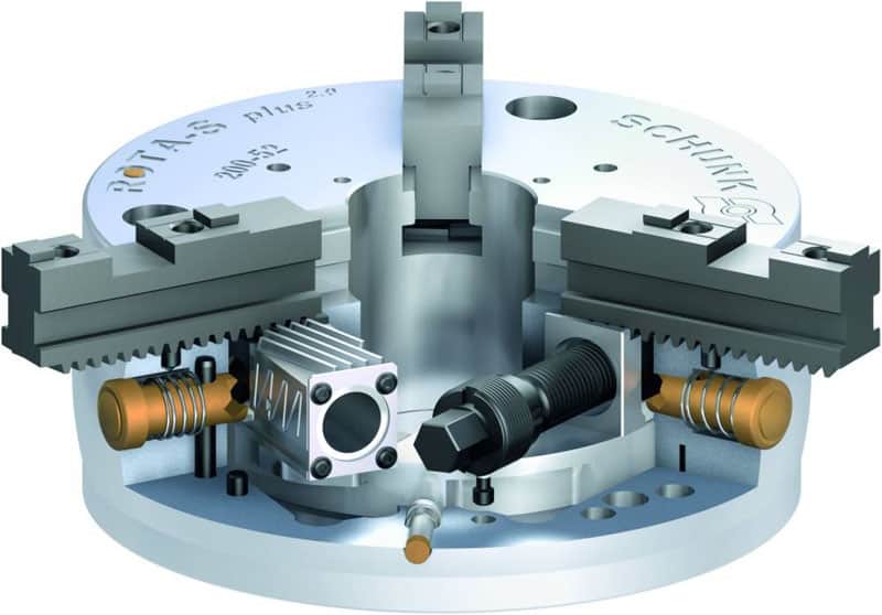

Tooling on a machine like this is important. My friend's Romi is equipped with a very nifty chuck made by Schunk in Germany. This chuck is a clean sheet of paper approach to the homely 3-jaw chuck that is so common:
Schunk Lathe Chuck...
Instead of a scroll, they use a wedge system that is more accurate. In addition, pressing a button allows the jaws to be slid quickly to the proper size so you don't have to wind it there with the chuck key. These chucks are not cheap, but they sure are beautiful and productive works of machine art.
