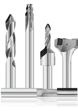

PCD Tools & Cutters
A wide variety of PCD cutters are available.
PCD Diamond Drill Bits
PCD Drill Bits come in a variety of flavors:
- "Vein" style has PCD infused in the grain structure of the bit.
- Brazed has cutting edges brazed onto the bit much like the end mill pictured below
- PCD Tipped has a solid PCD tip such as this photo shows:
Sorry, but there's no text provided to rephrase. Please provide the text.
Note the dark-colored PCD tip...
PCD End Mills
The photo shows a typical end mill with PCD cutting edges brazed on. PCD is formed in large High Temperature-High Pressure presses as either a diamond wafer on carbide backing or forming a "vein" of PCD within carbide.
PCD Inserts
Given that PCD bonded to carbide for brazed tools is available, it should follow that PCD inserts are available for indexable cutting tools.
