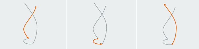

This video shows the wild tool path this thing takes:
The secret is the teeth on the end are little broaches. They cut a spiral groove just big enough to snake the thread cutters through in the groove. Those thread cutters are 180 degrees apart.
Now, once the punch tap is at the bottom of the hole, a quick half rotation is all it takes to form all the threads in the hole. Plus, since we have everything 180 degrees apart the broaches are lined up with the grooves, and we just reverse the entry spiral to back out.
Here's a schematic view of the motions:
Here's what the threads look like:
You can clearly see the broached spiral groove used to get the cutters to the bottom of the hole...
You can clearly see the broached spiral groove used to get the cutters to the bottom of the hole. What you're left with is a cold-formed thread done 75% faster!
