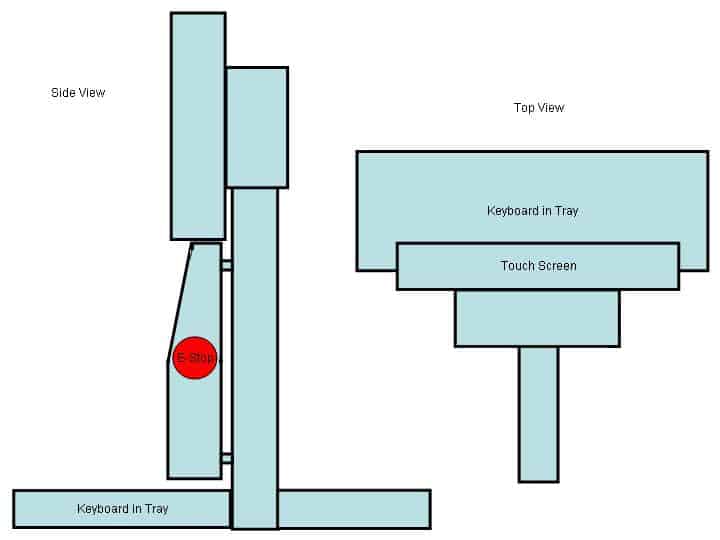

Concept:

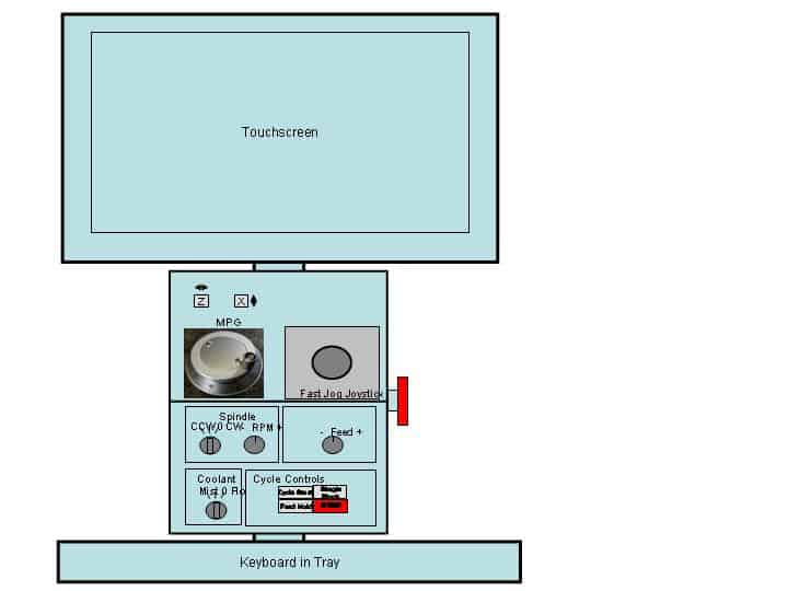

The idea is to attach a touchscreen, control panel, and full sized keyboard (in a tray) to a framework made of square tubing. The result should be stable in operation, yet not take up too much space on the bench. It will hopefully also look very professional and nifty. Most of the electronics for the overall lathe will be kept in a NEMA-style electrical box that sits on the floor beneath the lathe.
The panel can sit either to one side of the lathe, or even in front of the area that encloses the motor, making it easy to reach the controls while staying close enough to see what’s going on. I like the idea of a sturdy panel better than a pendant. My experiences with radio controlled airplanes tell me that when you have to both exert fine motion and hold the control box it is more difficult.
The MPG and Joystick will hopefully make manual operations easy and natural feeling. A touchscreen eliminates the need for a mouse, and makes it possible to access a bunch of soft configurable controls on the screen if need be. A full-sized keyboard lets me type productively if I need to power some g-code in.
Front View
Top and Side Views

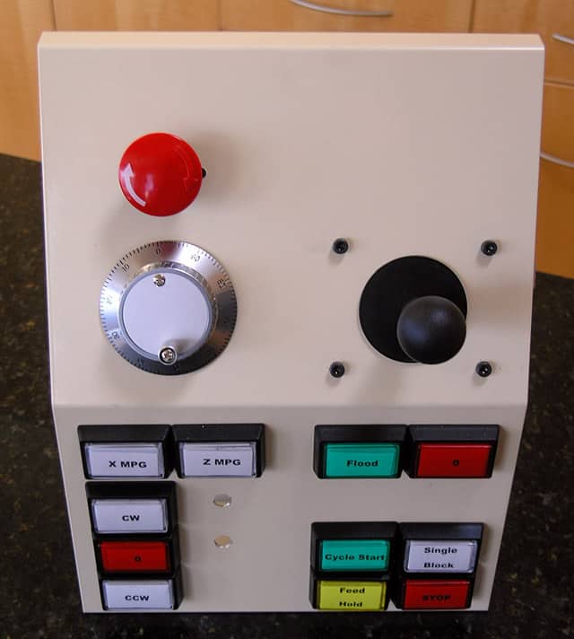

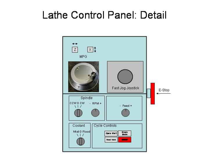

Detailed Functions
Rundown of Detailed Functions (Left to right, top to bottom):
– Z and X axis selector buttons for the MPG. MPG’s are expensive, so I need to buy one and switch it between axes. I’d like to have the active axis light its respective button as well.
– Fast Jog Joystick: This is an arcade-style industrial joystick with 4 microswitches. It’ll be connected to fast jog (shift+arrow in Mach) the axes much like the way Centroid controls work. I believe having both fast jog and fine mpg control will promote good manual feel in the machine.
– E-Stop: Fastened to the side where its easy to reach, but not too easy to accidentally reach.
– Spindle: The spindle cluster will allow manual operation of the spindle as well as a spindle speed override pot.
– Feed: A feed speed override pot is provided.
– Coolant: Manual control of coolant is provided.
– Cycle Controls: The cycle controls are used to manage the execution of g-code.

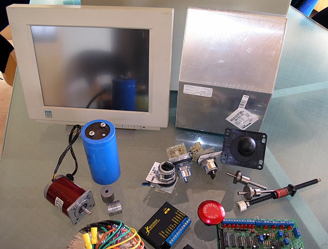

Parts Collected So Far |
Gathering Up Parts…

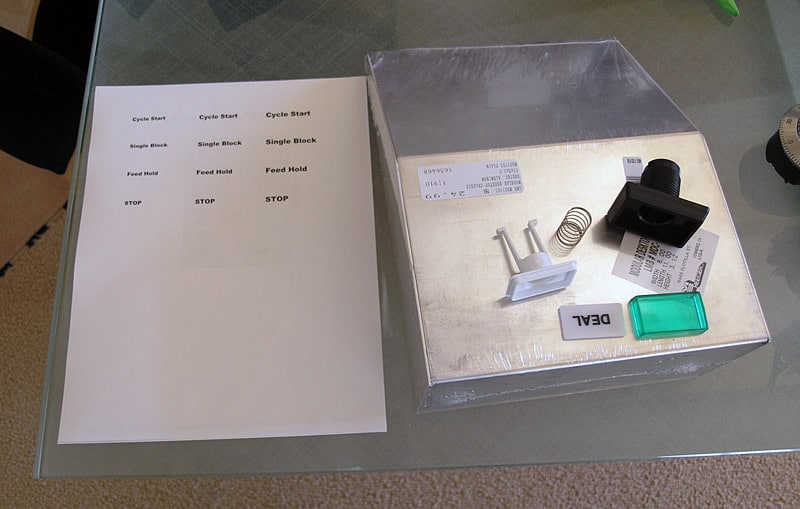

Here’s where I got the goods:
Slot machine buttons and Joystick: Happ Controls
Micronor Manual Pulse Generator: Rogers Machine
Enclosure: Action Electronics
E-Stop Switch: eBay

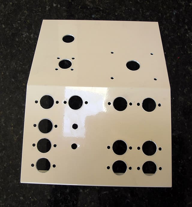

Initially, I’m just going to paint the panel and support frame PC beige to match the NEMA box and touchpanel, and then use stick on clear labels. Longer term I want to explore creating an engraved panel once I get my mill converted to CNC.
We can use slot machine buttons…

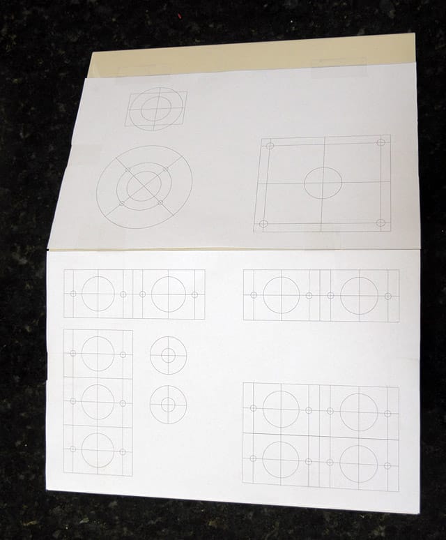

Rhino 3D actual size CAD drawing to layout the holes…
A few chips later, and fresh of the drill press we’re ready to mount the controls…
Voila! Still need to purchase 2 pots for spindle and feed overrides. Not too shabby, eh?

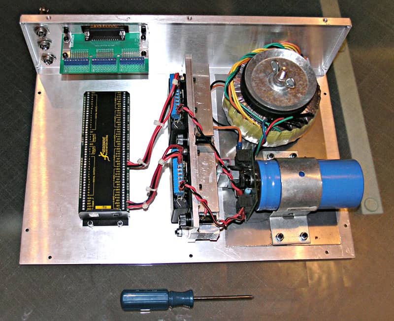

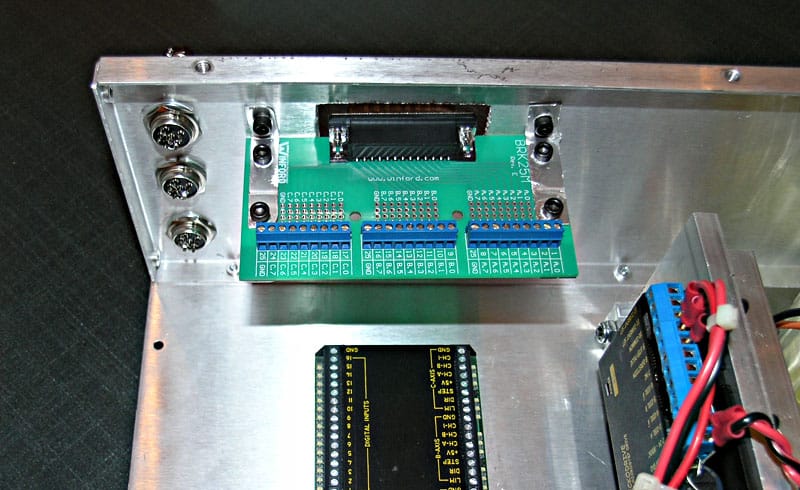

To facilitate the point-to-point wiring from the parallel connectors, I plan to use a simple screw terminal breakout board:
These boards are pretty cheap at $20 a pop and will make my life easier and the installation neater. Wiring the panel just consists of running the point to point connection from each control back to the parallel breakout board. In the driver enclosure, the process continues, with a point to point connection running from breakout board to each appropriate GRex input.
Parallel card for panel and microphone connectors for 2 step motors and limit switches…
