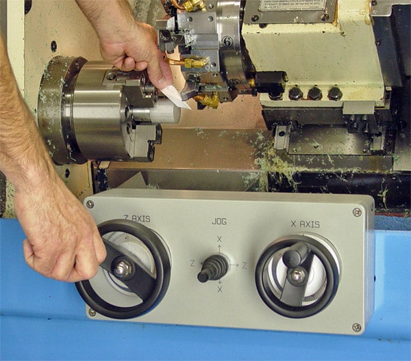

But there are answers to the lack of spontaneity problem. There are commercial lathes available that try to fit this bill. They give the operator manual controls that include even handwheels. It's just that the handwheels are now electronic encoders rather than actually driving leadscrews:
A man's hand grasps a metal piece on an industrial machine with control dials, in a workshop or factory setting.
CNC with Handwheels and Joystick...
The CNC people call the handwheels "manual pulse generators" or MPG's. I'll be looking into the whole idea of MPG's as well as seeing what the current crop of CNC software offers to the manual machinist who wants to make one-offs. Having a set of wizards to make it easy to do simple operations without CADCAM is called "Conversational CNC", and it works well too.

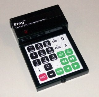

Second, I purchased a Frog CNC controller. The Frog is a single axis CNC controller built around a microcontroller that is basically an e-leadscrew. It was intended to control threading and has some limited abilities to do other things. The bad news is that the guy has quit making them, and is selling of his last stock of 8 units. I jumped at the chance because it wasn't that much money on the grand scheme of things and I figure I can always resell it or perhaps use it to control a rotary table.
The frog is cute as a bug:
A black rectangular CNC machine control panel with white keypad and red button.
Frog CNC Controller
We will see how well I wind up liking it. There is a Yahoo group aimed at Frog users if you want to know more. I want to play around with the Frog and use it as a test bed, but it is unlikely to be my final stopping point given that it is now an orphaned product. Of course if the E-Leadscrew gang never finishes a useful gadget, I may have to be satisfied with the Frog!

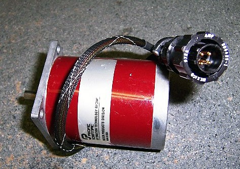

Third, I have been educating myself about CNC. The motion control infrastructure needed to drive a lathe axis with a stepper motor is the same in all cases, so this was the first area I looked into. I got a lucky break on eBay (again!) and was able to acquire 5 excellent Pacific Scientific 210 oz in stepper motors for only $34:
Red cylindrical stepper motor with black cord on dark gray surface.
Pacific Scientific Step Motors...
I think they'll be perfect for my purposes. You can read more about this infrastructure work by clicking my links for that as well. I took a brief detour toying with a design for a simple manual pulse generator to drive these steppers so that I can use them simple for power feed purposes. I have laid out the board so that the stepper infrastructure may be controlled either by the manual board or a CNC breakout board, which offers another approach to conversational CNC. One could select either the tactile manual controls or the CNC PC. In the end of the day I might even rig up a stepper powered manual XY table for my drill press, but that's a whole other project.

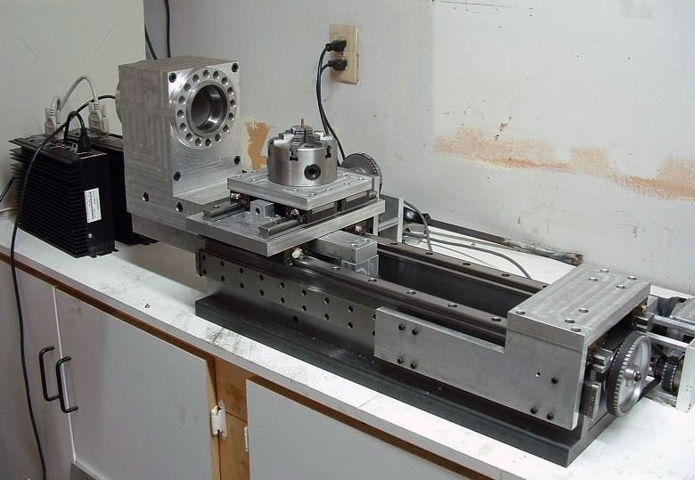

After this protracted wandering in the dessert, I finally arrived at a plan, and a Blog. I would build a CNC lathe around conventional CNC conversion techniques. By that I mean I would be using stepper motors on both axes, Mach 3 Turn software with attendant wizards, and an elaborate control panel designed to maximize the potential for manual operations with as little pain as possible. If all goes according to this plan, I will be able to both run traditional CNC operations, as well as do quick back of the envelope operations. If nothing else, I'm about ot learn what the limitations of amateur desktop CNC really are.
Red gear with teeth against dark background.
The Plan, Part 2
Assuming I embrace CNC wholeheartedly, it would make sense to improve the backlash situation on the lathe with ballscrews. It is also tempting to try to build my own CNC machine tool someday:
Home-built CNC lathe in a workshop setting, with metal frame, precision components, and control panels.
Since I began this journey I have acquired a CNC Mini-Router as well as a conversion kit for an Industrial Hobbies mill. After playing with the mini-router I covet a much larger router, and probably a plasma table too. There seems to be no end of CNC possibilities to play with, but it all started here with the lathe!
