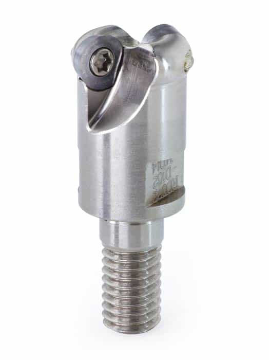

If so, you'll know that these versatile tools can really do a good job for you. They're commonly used for pocketing, die/mold roughing, face milling, slotting, step milling, and even helical interpolation of holes.
There's a lot to recommend round inserts as they have a number of properties that contribute to their success. If you've used one turning, you'll know that their large radius can yield some very nice surface finishes. They can leave a good finish when milling too, but they have a number of other advantages.
Their round shape makes them particularly strong as they have no weak corners that can chip. If you do wear or chip one, they can be rotated to expose a fresh edge.
They're advantageous for lighter machines too. When operating at heavier depths of cut, they create cutting forces that are more radial. But, by taking a lighter depth of cut, they transition to behave more like high-feed machining tools. This means most of the cutting forces are directed straight up the spindle, which is the strongest rigidity on any machine. It's one reason plunge milling is so advantageous on light machines. Button Cutters provide an alternative.
It seems that for whatever reasons, the physics of cutting favor circles. HSM toolpaths do better than conventional paths by adopting loops rather than sharp corners. And copy mills do well because corners on inserts are a weak point that can chip or break off. You can load up a copy mill pretty hard and they'll hang in there. If you do manage to chip one, just rotate the insert until the chipped portion is not being used and keep going.
You can think of button cutters as the indexable tooling version of corner radius end mills, also called bull nose end mills.
OSG Button Cutter...
In the most demanding applications, button cutters compete with high-feed cutters. For many shops, a high-feed cutter is a direct replacement of their button cutter that allows them to crank up the feeds and speeds. For this reason, some have said copy mills are on their way out. But, there are cases where the button cutter still makes better economic sense:
- On older or lighter machines that can't achieve the performance needed by high-feed cutters.
- With extremely tough materials where the ability to rotate a worn insert and keep going gives button cutters an edge.
- In re-roughing applications and applications with extremely hard materials where a button cutter's round inserts are just stronger and tougher, so they last longer. Machining of welded parts is particularly well suited since the button cutter handles the hardened welds so well.

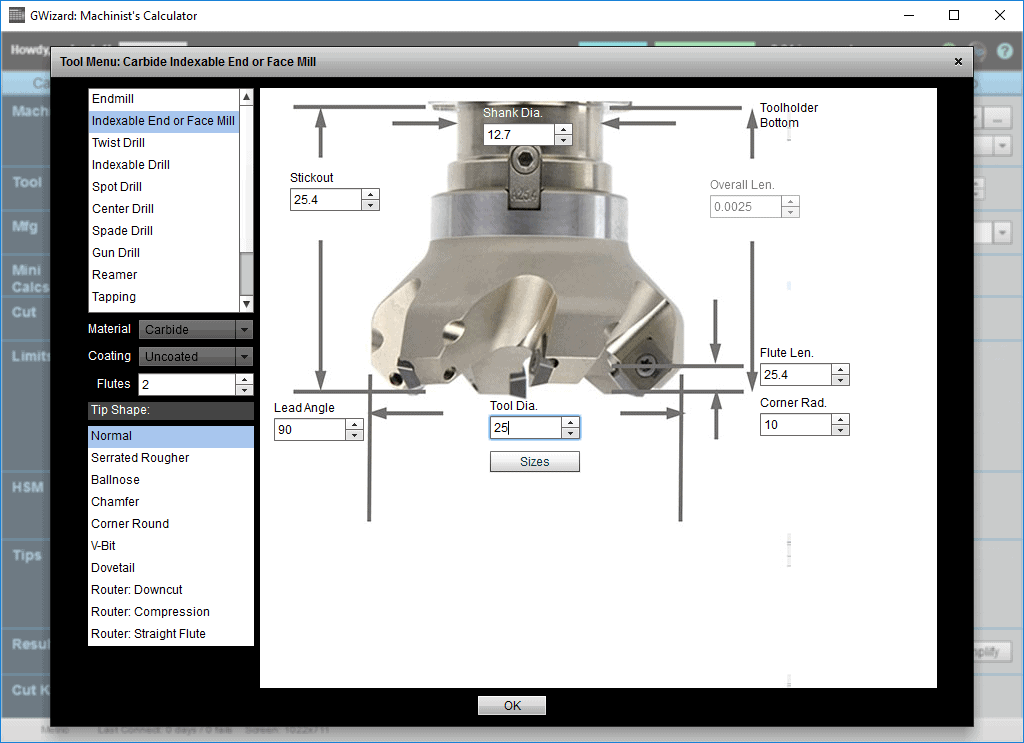

Setting Up G-Wizard Calculator for a Button Cutter
Setting up a Button Cutter in G-Wizard is pretty simple. We'll use Tormach's 25mm cutter as the example. As mentioned, it has a 25mm diameter. It uses a round insert with a 10mm radius. So, choose an Indexable End or Facemill tool type, tell it how many inserts (3 for the Tormach) or flutes, and click the "Geometry" button. Set it up as shown:
Set up a button cutter as an endmill with a big corner radius...
Basically, you just want to set it up with the right diameter and corner radius.
BTW, there's a trick if you are running in Imperial and want to enter metric values. So, for the Cut Diameter, I entered "25/25.4" and hit Enter and it did the calculation right in the field. You can also enter "25m" to convert mm to inches and 25i to convert inches to millimeters.
