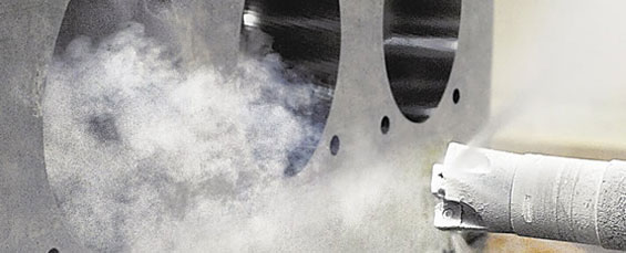

Chilling your cutter with Liquid Nitrogen (LN2). Image courtesy of 5ME.
Have you ever heard of Cryogenic Machining? Better yet, can anyone reading tell us your personal experiences with it?
Cryogenic Machining is the process of using Liquid Nitrogen (LN2) as the coolant for machining instead of ordinary flood or mist coolants. It can produce some amazing results in hard material–good enough to offset the expense of the special equipment and LN2 needed to perform this kind of work. We’ve just uploaded another chapter in our free Feeds and Speeds Cookbook on Cryogenic Machining, and if you’ll pardon me for saying so, it’s very Cool Stuff indeed!

Thermal shock?
Jim, you raise a good point. I did a little research, and the gist is that there is some thermal shock with Cryogenic Machining, but it is much less severe than with Wet (Flood Coolant) machining. Of course it is absent altogether in Dry machining.
Seems like the benefits outweigh the thermal shock drawbacks.
I also saw a reference to a particular grade of Carbide, K420, that was being used in these applications and claimed to have higher resistance to thermal shock.
