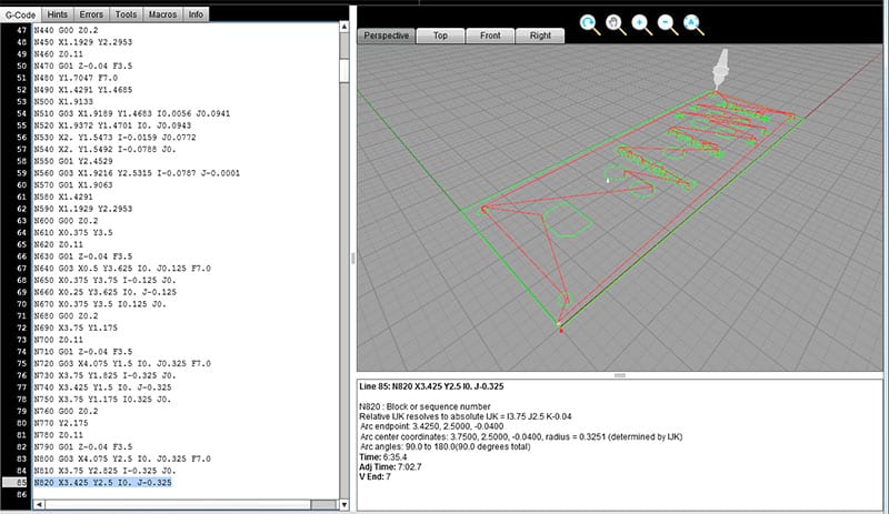

Learning G-Code
We get lots of students in at CNCCookbook who want to learn g-code. Our free GCode Tutorial is one of the most popular if not the most popular NC Programming resources on the web. When a semester starts, we get block signups from students looking to use the software in class. Pencil, paper, and books are fine, but there’s nothing like a fully interactive simulator to help you get your NC Program running and to help you understand what it’s doing. In addition, G-Wizard has features that are specially designed to make diving into g-code much easier for beginners.
For example, our Hints feature tells you what each line of code will do in plain English. Students tell me that the Hints are an absolute life saver that helps them come up to speed on the g-code radically faster.
Hints are in the lower right corner, below the graphical simulation…
Any time you click on a line of g-code or a portion of the graphical plot, you’ll see a hint for the line of g-code you’ve selected. These hints tell you everything that’s going on with that line, including a lot of things that are otherwise hard to come by.
