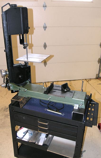

I was a packrat for raw metal back in the day.  Plates, structural steel, and long rounds were piled all over my garage shop.  Almost all of it was too large for my machines, so before I could do much of anything, it had to be cut down to size.  I started out life with the ubiquitous little Harbor Fright Band Saw:
The ubiquitous HF Bandsaw...
I paid all of $41 on eBay for the thing (it had some cosmetic issues), bought a decent Starrett bimetal blade for it that cost more than the saw, and proceeded to hate on the little stinker through many projects.  What you see is what it looked liked towards the end of its useful life.  I'd mounted it on a cart (for more storage and portability), added a nice table for upright work (normally it saws in horizontal mode), added a little oil dropper to lubricate the cut, and generally learned how to tune it up to work with the minimum of hassles.  After all that, and especially after I learned to tune it up, it was decent, but very slow and still somewhat finicky.  What do you want for $41?!??
