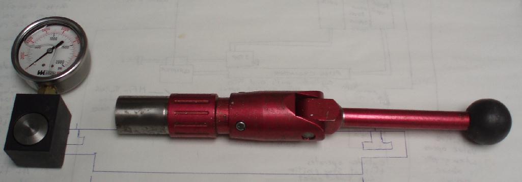

- Ensuring proper use of workholding. Any time workholding is manually operated, the potential exists to apply poka-yoke to achieve better results. Perhaps your milling vise can make a thin-walled part deflect if it isn’t set to proper torque. Provide a torque wrench to tighten the vise. The Repeater from Proclamp is one such device:
The Repeater is designed to allow repeatable torque on milling vises…
