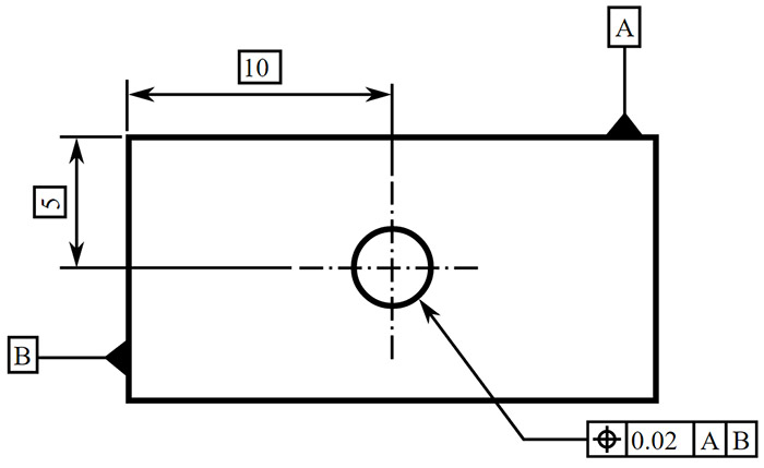

Basic Dimensions
When you see a number in a box, that's a Basic Dimension.
A number in a box denotes a Basic Dimension. Image Source
Given that there is just a number in a box, Basic Dimensions have no tolerances.

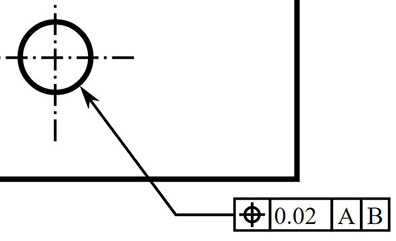

A Feature Control Frame describes the conditions and tolerances of a geometric control on a part's feature. A feature control frame contains four pieces of information:
- GD&T symbol or control symbol
- Tolerance zone type and dimensions
- Tolerance zone modifiers
- Datum references if the GD&T symbol requires them
Each Feature Control Frame will typically (it is optional) have a leader arrow pointing to the feature it describes. Consider the Feature Control Frame in the drawing b:
A Feature Control Frame...
The Leader Arrow points to the hole feature. It has a Geometric Symbol, in this case, a Position Symbol. Given that this is a round hole, the tolerance could be a diameter, in which case we'd have a diameter symbol ahead of the tolerance. Instead, we just have a tolerance value, so this is a positional tolerance for the center of the hole. We could follow the tolerance with a Tolerance Modifier. The "A" and "B" are the primary and secondary datum. If we look to the original drawing (top of page) we can see that these tell us where to measure the hole's center from. In this case, "A" denotes the top edge of the part and "B" denotes the left edge.
This is a lot to take in, and we're not trying to completely describe every aspect of Feature Control Frames here. Rather, we are introducing a concept we will elaborate on more fully later in the tutorial.
