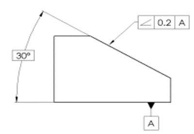

Angularity Callouts on Drawings
Technical diagram featuring a 30° angle and 0.2 unit measurement.
Use of Angularity in a drawing...
Use of Angularity in a drawing is straightforward. Simply callout the Angularity allowance in a feature control frame with an arrow leader designating the surface being controlled. Be sure to include the Datum for the Angularity.
In the example above, there are three callouts:
