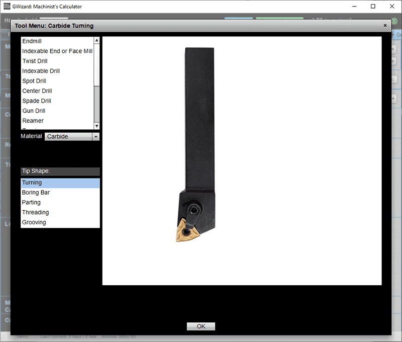

New Graphical Lathe Menus
The graphical tools menus are here for turning tools:
You didn’t provide any text to rephrase. Please give some text in order for me to assist you.
Just select “Turning” from the main list and then choose your Tip Shape to get Turning, Boring Bar, Parting, Threading, and Grooving tools.
Seems like such a little thing to describe, but graphical menus are so much more satisfying than just a simple list.

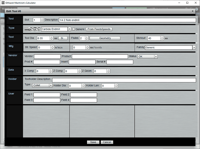

Tool Crib Now Handling Tool Holders
I’ve added a set of fields to help keep up with tool holders:
There’s now a “Holder” row in the pop up tool editor for the Tool Crib that has:
- Description
- Type
- Holder Diameter
- Holder Length
Types include:
- Other
- Collet
- Weldon / Side-Lock
- Shell Mill / Arbor
- Drill Chuck
- Compression Tapping
- Morse Taper
- Shrink Fit
- Milling Chuck
- Hydraulic Chuck
Together with the ability to track Serial #, empty holders (a tool type) and vendor re-ordering information, this gives the ability to uniquely identify all the tools and holders in the shop.
There’ll be more functionality to help out in that area soon.
