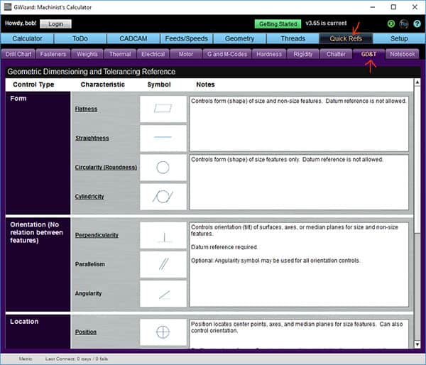

New GD&T Applet for Quick Reference
Many of you have been following our free GD&T Course.  Geometric Dimensioning and Tolerancing is handy stuff for CNC’ers.
G-Wizard Calculator already had some pretty useful aids to GD&T built in.  The Fits and Tolerances app for one and the True Position Calculator for another.  Now we’ve added a GD&T Quick Reference to help you keep up with what all the symbols mean:
GD&T Geometric Dimensioning Tolerancing Quick Reference Symbols Calculator
New GD&T Quick Reference is under the Quick Refs as the GD&T tab…
The new GD&T Quick Reference is under the Quick Refs as the GD&T tab.  What you get is an expanded quick reference table and clicking through the links will bring up the articles from the GD&T course that explain each symbol more fully.
Handy stuff!

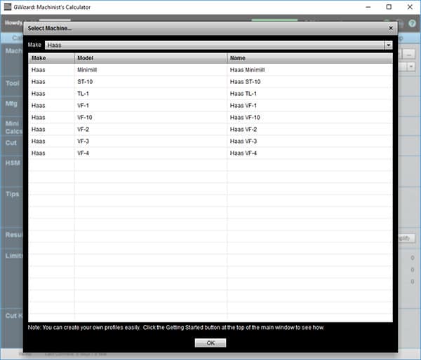

New Machine Selector Popup
In preparation for our adding a LOT more built-in machine profiles, I wanted to make it easier to manage the long list of default machine profiles that is going to start growing steadily.  So, I changed the Machine Selector Popup so it is in a bigger window and so you can filter by machine make using a dropdown.  For example, if you only want to see Haas machines, use the dropdown to shorten the list:
machineselector
Filter the machine list by make, such as Haas…

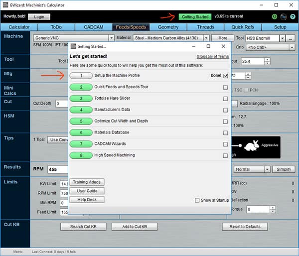

BTW, it is super easy to create a machine profile for your machine if it isn’t on the list.  We even provide a guided tour in the Getting Started tours.  Just click the Getting Started button at the top of the software window and access the tour:
machineprofilequickstart
It’s easy to create a machine profile.  We even provide an easy Getting Started Tour to show you how…
