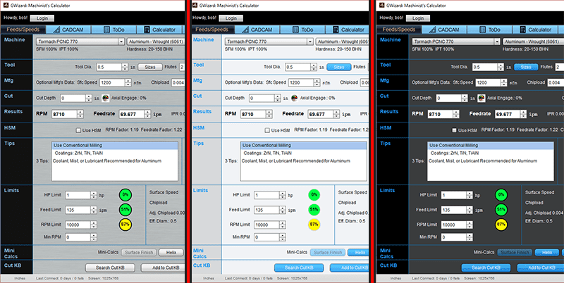

Second, I wanted to freshen things up to make the interface look more modern and visually interesting.  Towards that end, I've introduced the concept of "Themes".  There are three of them that you can choose under the Setup tab:
You didn't provide any text for me to rephrase. Please provide text for me to assist you correctly.
The Themes are called "Original Flava" (very similar to prior look and feel), "Lighten Up", and "Dark Mood".  Here's what they look like side-by-side:
Two computer screenshots of a machining calculator software with different parameters being entered.
Here are the three new Themes side by side for comparison...
In this iteration, you can switch themes and see the result immediately, except for "Original Flava".  You have to exit and restart to get it to take full effect for obscure historical reasons.  Of course, G-Wizard will remember your chosen theme from one session to the next, so pick one you like and settle on it.
