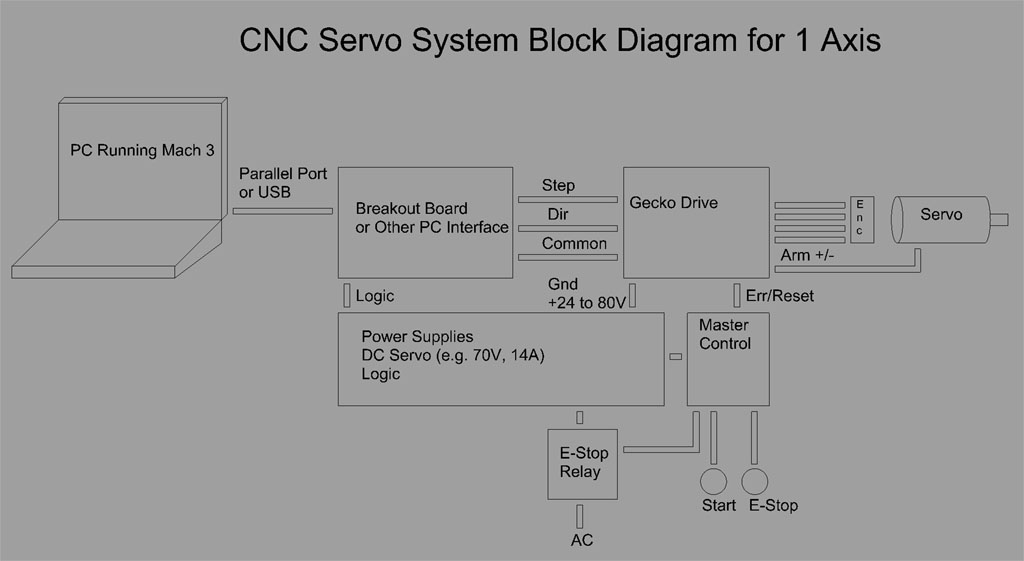

The CNC Servo System Block Diagram
The CNC Servo System Block Diagram is our roadmap for debugging. It shows the different components, and how they fit together. It's a roadmap because signals have to successfully travel from left to right to make the servo (or stepper) motor spin under Mach3 computer control. Problems can develop at any point along the way, interrupting our journey, as well as the excitement and fun of our CNC project. So the focus will be to move from left to right on the diagram using various means to test whether the magic signals that control our machines are able to get to the next stage. Many (I was!) will be tempted to connect it all up and throw the switch. Things might just work the first time for you. But if you hit a glitch, try following the roadmap until things are going again. If things are terribly wrong, connecting everything will expose more components to damage as well. For that reason, the most prudent approach is to connect one axis at a time as much as possible and get it working all the way through for that axis before going to an additional axis. Once you have one axis working all the way through, it becomes much easier to get the others running too, because you have confidence in what works.
Accordingly, each section below is about one of the building blocks in the block diagram and how you can verify things are functioning correctly up to that point.
Power Switch, Master Control, E-Stop Circuitry, and Power Supplies
Why start with the power supplies? In a word, because it's easy. All you need to check the power is a voltmeter. It doesn't take but a few minutes to go through and check it out.
Be sure to set it for AC or DC depending on which one you want to measure. In some cases you'll be checking for continuity with the ohmeter. The power swtich, master control, and E-stop circuitry are all there to make sure power is applied when desired and taken away instantly if the situation calls for it.
