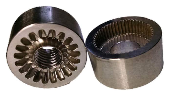

Voxel is a start-up company focusing on a process called Pulsed Electrochemical Machining (PECM). Unlike other material removal processes which cut, abrade, or ablate metal, our PECM process dissolves the material and we do it without any tool wear. We take products from R&D or prototypes all the way to production with a focus on tight tolerance designs and hard-to-machine alloys in the medical, energy, and aerospace sectors.
Bevel and straight gears manufactured with PECM...

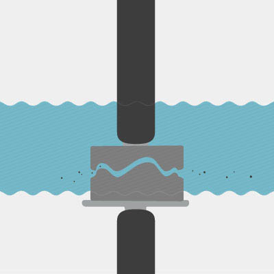

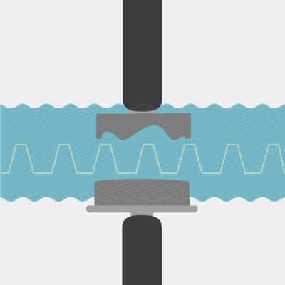

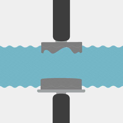

It's easiest to describe the process in pictures:
Step 1: Cathode and anode are set-up and electrolyte is pumped between the two parts.
Step 2: As the two pieces move together a pulsed DC current is applied.

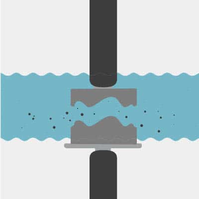

Step 3: The flowing electrolyte removes heat and waste products from the gap.
Step 4: The anode workpiece is then machined into the complimentary shape of the cathode tool.
Step 5: The resulting piece has no thermal surface effects, high repeatability, and can be made from alloys that are otherwise impossible to machine conventionally.

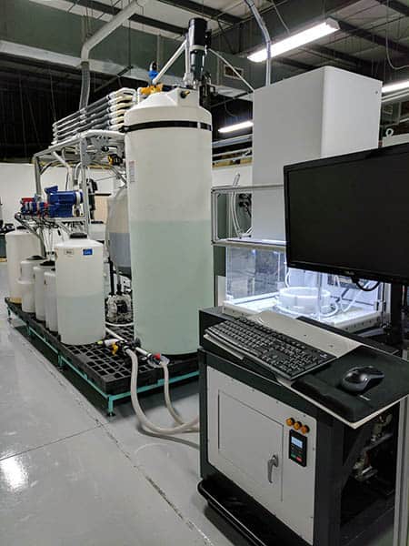

Here's one of their PECM machines and the waste water treatment cell...

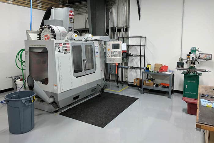

VMC by Haas, Feeds and Speeds by G-Wizard Calculator

Michael Bromley: As we grew we decided to bring conventional machining methods in-house to accelerate the path from design to prototype. The PECM process requires jig/fixturing just like any other machining process and outsourcing it was consistently stretching our timelines. We decided to purchase a used Haas VF3 and at the same time GWizard Calculator to make the most of it.

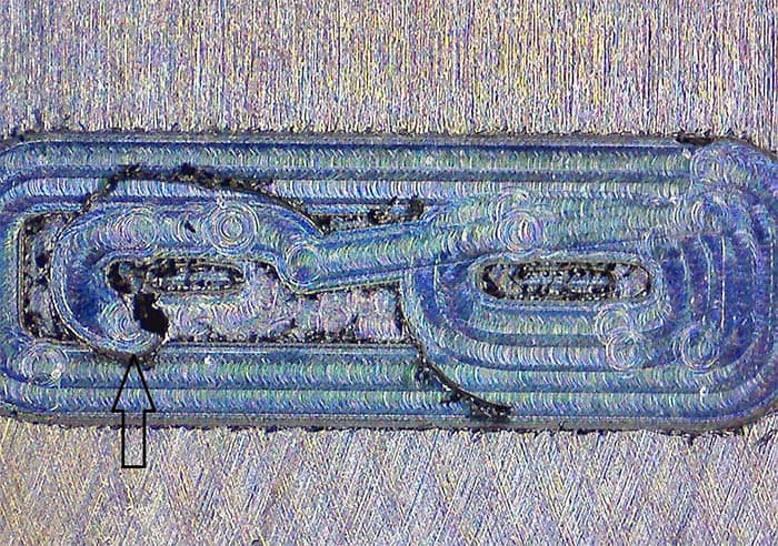

GWizard has already proved invaluable in a micromachining scenario; we needed to cut some tooling for our process using a 0.01” ball end mill in stainless steel. Utilizing the manufacturers recommended feeds and speeds consistently resulted in broken end mills and wasted time. After a handful of attempts we went with GWizards feeds/speeds recommendation and it worked the first time! When evaluating the previous settings GWizard warned of tool rubbing due to moving too slowly which correlated well with our observations under a microscope.

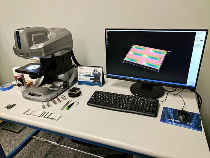

Machining features this small and accurate requires serious metrology!
Here's a picture that I thought you may find interesting. It is an image under our microscope when we were diagnosing the micromachining issues. The cutter there was a 0.01” 4 flute carbide square end mill. You can visibly see the rubbing and the pushing of material as opposed to cutting. That is when we turned to GWizard which actually recommended much faster feed rates than we had been using.
Here's an actual photo Voxel took of the rubbing effect when your feedrates are too slow.
