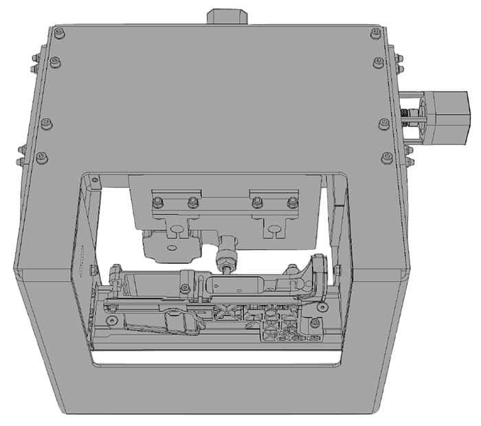

The machine has a 10,000 rpm ER-11 collet spindle and a smallish work envelope that's optimized for machining lower receivers (the part of guns that is regulated, more below).  That machinable area is 6.75" x 2.95" x 2.35" and the maximum size of a part that can fit inside the machine is 9.05" x 3.5" x 3.9".
One thing interesting about the machine is that it uses a horizontal milling format rather than a vertical format.  There are many advantages to horizontal mills having to do with rigidity, the ability of chips to fall clear due to gravity more easily, and many others.  This is the first time I've seen a small mill in this format:
Gray box with open front panel, internal components visible, square shape with rounded corners and small screws on edges.
The Ghost Gunner is set up in a horizontal milling format, with the spindle parallel to the table.  An AR-15 lower receiver is depicted in this drawing from the User Manual...
Ghost Gunner reads a file format called ".dd" files which are supposed to be subtractive CNC's answer to the STL files of 3D Printing.  It can also handle standard G-code via its Grbl Controller.  It ships with a set of 3D Printed jigs suitable for Mil Spec AR-15 lower receivers.  More DD files to create jigs for other lower receivers including 1911 pistols and AR-10 rifles are supposedly coming.
Ghost Gunner's Mounting Plate consists of 2 T-Slot rails spaced 40mm apart.  It also includes a built-in probe to make setup easier.  The probe works by closing a circuit rather than a mechanical switch, so it is simple and reasonably accurate.  It does assume the part is insulated from the Mounting Plate and that it is made of conductive material.
