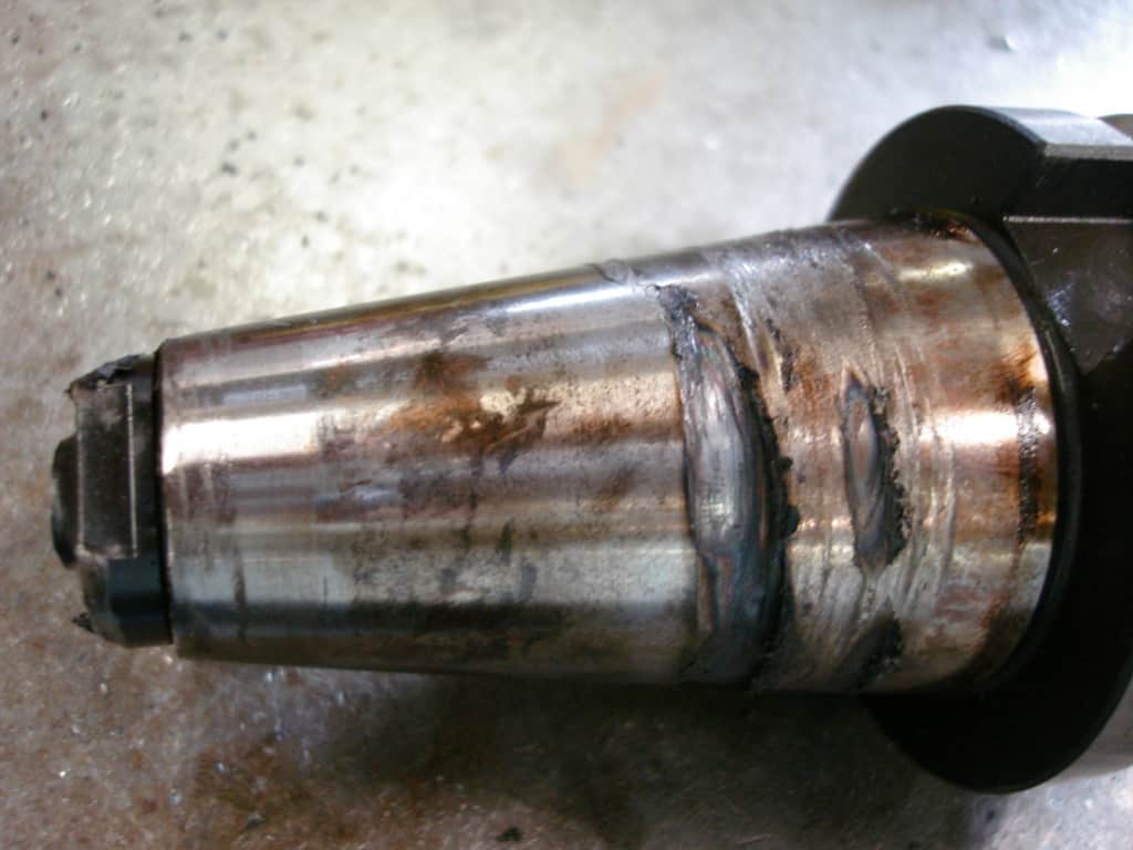

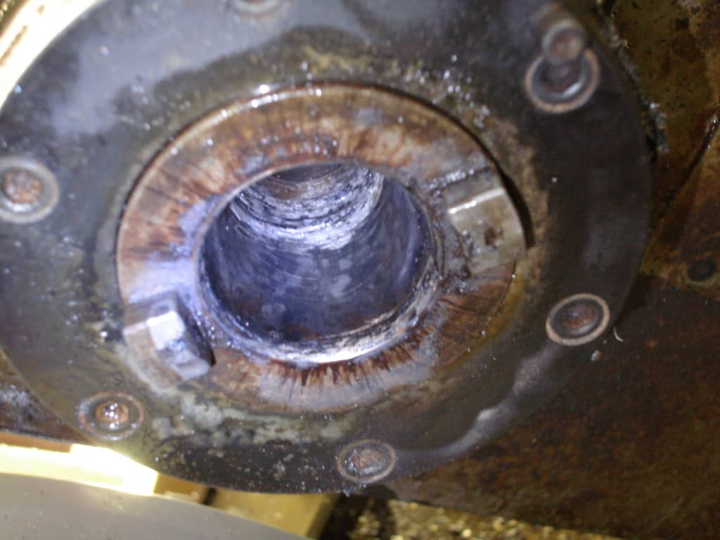

Here’s the story. Seems a customer of Frank’s had been ignoring pull stud replacement. Eventually a Bad Thing happened to a tool holder and his machine’s taper:
Whoa! Seriously chewed up with a fair amount of horsepower…
No love at all in the spindle taper. Take care of your pull studs, people! Check the drawbar tension while you’re at it too.

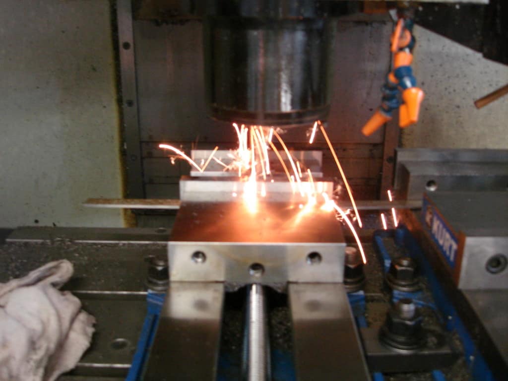

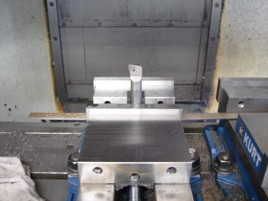

So, the good doctor prescribes a boring bar with a diamond insert (PCD). This is a hard turning application, meaning that the bore is hardened. The bar and insert are only used for spindle taper work, so they’re pristine…
Sparks like this are normal in hard turning…

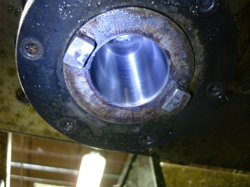

Wow–serious improvement!
A few notes:
– Mari “tweaked in” the spindle by bluing a spindle test bar and tweaking his program.
– When the program was fully tweaked in, he ran the bar to identical start/stop points 4 times.
– Accuracy afterward measured to 25 millionths at the top. .00015 at 8 inches down using the test bar. Total elapsed time for the work: 1 hour.
Sending your spindle out to be reground at a spindle shop would probably produce better results, but this is a lot cheaper and faster. Something to consider if your machine is older and not worth the more expensive treatment.

Someone must have wished they had some ear protection with the amount of damage shown… WOW!

How do you determine when to replace pull studs?
when you can actually see any deformation or, “fresh Metal” on the grappling stud…..if you can see any, ‘ugly spots’, it’s best to check the drawbar thru the spindle to see if it also has any deformation or gall marks….replaced many a drawbar and pullstuds in our machines….usually because SOMEONE (I won’t refer to them by name online), refused or forgot to blow any chips and dirt/dross from the mating surfaces….makes me CRAZY…grrr…
You’re absolutely correct….many don’t realize that the few thousandths of mat’l one grinds off, can have a deleterious effect on properly snugging up the taper to pitch…..one also has to mate the FACE (sans drive dogs) to the proper pitch in relation to the tapered bore…
